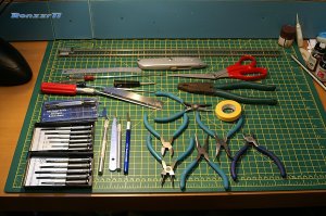

This is the selection of tools I have by my layout,I can handle most modeling tasks with these.
