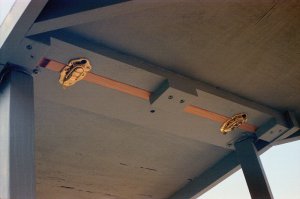

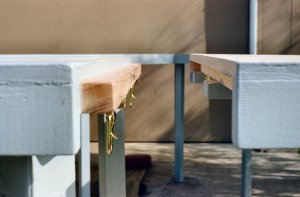

It's been awhile since the request was made, but here are a couple shots taken during a "corner test", showing the end construction of C+D module sections (without track or wiring), and how they go together...

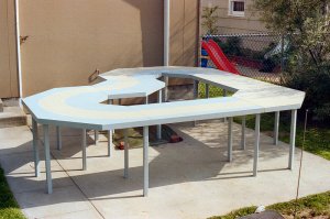

The corner test checking for 90 degree alignment of all six corners, with the minimum of two straight sections. The corners were then shuffled, and the test was made again. The result: Outside corners are interchangeable, indicating that adequate "squareness" of each corner had been achieved! :)

Hello, Alex...
The straight sections are basically 2 feet wide and 4 feet long, with provisions for adding additional space to the front and rear edges. Corners are based on a 3 foot square with the outer and inner apexes removed. These dimensions don't count the 3/4 inch tongue that extends from each male end.
Hi Chuck, I really like your idea on joining the modules together, excellent! When I think of all the jiggling to get the club modules fitted properly and secured with bolts, just how many problems a system like yours would have prevented. I don't know but to me it looks like your system would fit together perfectly every time with little effort, stay tight together without movement. Nice post, the system could be used in any scale.
Cheers Willis
Hi Willis!
You're right, the system is not gauge exclusive. It is also adaptable to more sophisticated scenery techniques, something we will be exploring as the hirail area of the layout expands.
When designing the system, it was my hope to eliminate some of the steps needed for assembly. For several years, I observed modular groups like the Tinplate Trackers and others setting up, tearing down, packing, unpacking, etc. There's a lot of work to do in limited time, and I knew if Di and I were going to have a layout of any size that we could wrangle on our own (should the need arise), the procedure would need to be much more streamlined than what any existing modular system required.

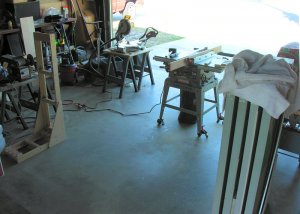

Meantime, this has been the scene inside our garage for the last few months...

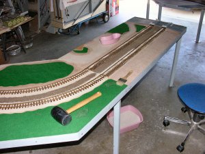

There was lots to do. I think we got about 25% of it done. Racks have been built to carry the layout sections and their "add-ons", and all Gargraves track has been ballasted, as seen below.
"Concrete" areas were redone, and dirt scenery was applied. Various minor but crucial repairs were made. Actually, the whole thing worked better than I expected after six years of storage.

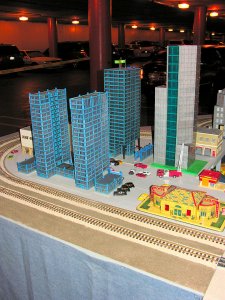

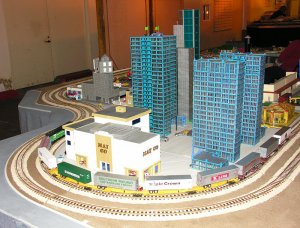

The city was laid out a bit differently from the 2000 convention. The C+D headquarters towers were placed where the 1960 Kenner building had been (didn't have tiime to rebuild that one), and Jim Radke's May Company department store (kitbashed from several Plasticville hospitals) was placed in the horseshoe...

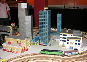

Another view of the city, which is beginning to look like a "blue metropolis". Gotta get more of the old Kenner buildings up again...

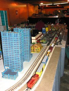

From the "South" side...
Jim's fire station appears at lower left, and things look busier than 2000.

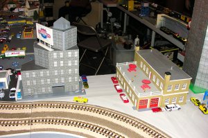

A closer look at Jim's kitbashed plasticville fire station (right) and his Irwin-era G+P building...
