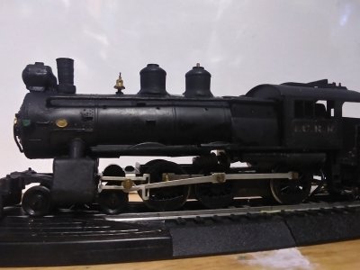

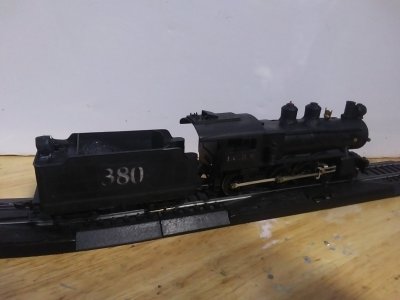

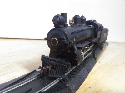

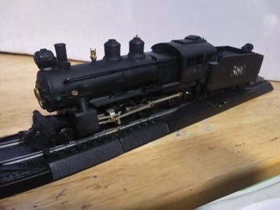

What stared as a 4-4-2 conversion to a Casey jones (Illinois central) 4-6-0, became a one of a kind model of its own.
This is my build of I.C.R.R #380. (Fictional Model).

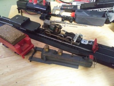

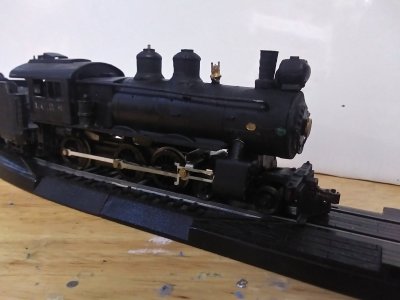

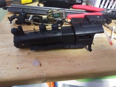

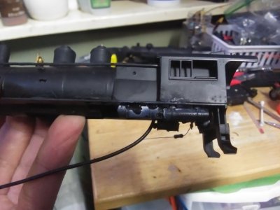

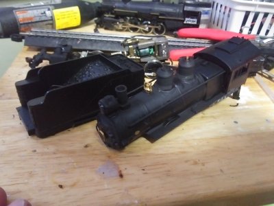

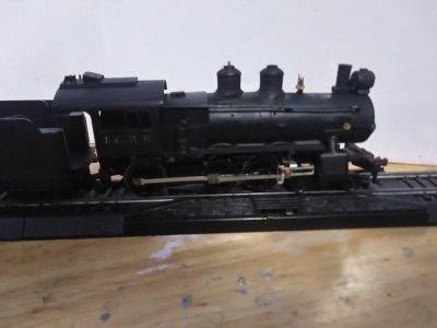

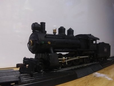

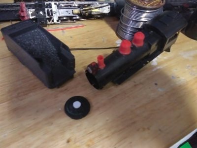

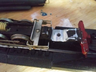

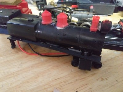

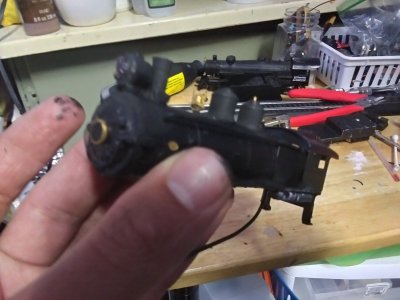

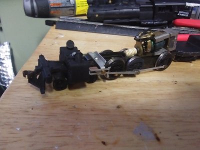

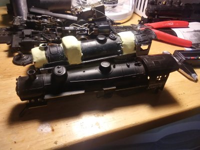

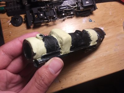

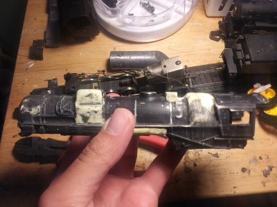

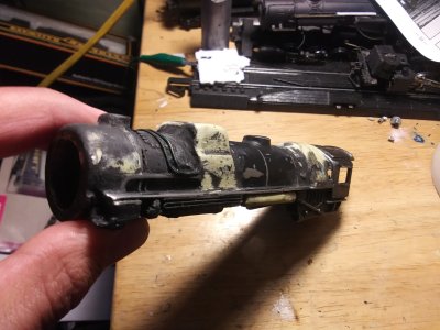

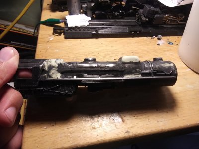

In photo one, you will notice the 4-4-2 Atlantic in the back. I don't want to go through all the details, but in short I have never had tried to do a locomotive conversion by "Adding" another driving wheel. I did not know how to make coupling rods (Which has been done by more experienced modelers) and had know idea what I was doing! 🤣 😖
So I opted for using a Mantua 4-6-0 with smaller drivers and swapping the locomotive body for the Atlantic.
The Atlantic looks a lot like (With modifications) Cassy Jones 4-6-0.
I cut and reorganized some of the details to similarly match those of that loco. But as I continued to work on the engine I decided to make it a another number (Even If its not accrete to the prototype) that way if I pick up a Rogers from AHM, It will still be different.

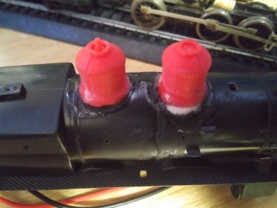

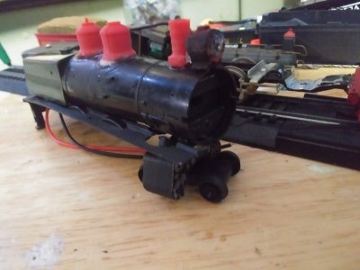

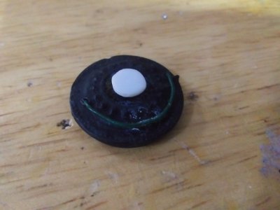

The Domes, funnel and head light are designed and 3d printed by me. I am very proud how they came out.

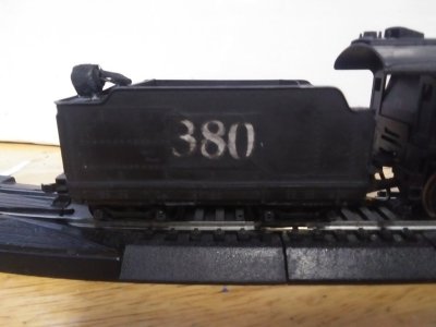

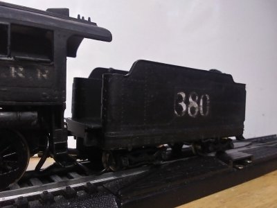

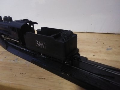

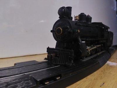

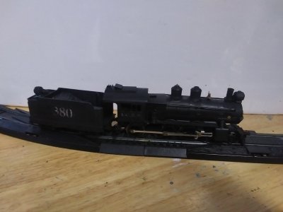

Once Painted I added my own "Decals". It is standard printer paper deco-podged to the engine. I then sort of rub black pain on to give it a weathered look and to make the paper blend in better.

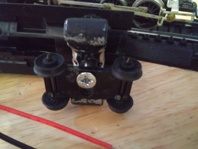

That's about it. It took a little work to get the body to fit the base of the 4-6-0, but I think It looks great overall.
The head cannon behind the engine is simple.
In Casey's early years of being a engineer, the I.C.R.R Made a better 4-6-0 porotype (By making a bigger boiler) and had Casey put it through its paces. It would have worked well, but the smaller drivers became a set back. Later locomotives after this one were equipped with larger drivers. Despite this, Casey did use the engine off and on when he was not driving #683. This paved the road to him eventual being the engineer to #382.
Love to hear what y'all think.

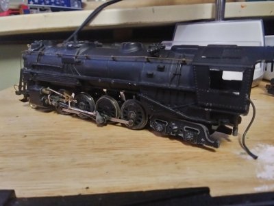

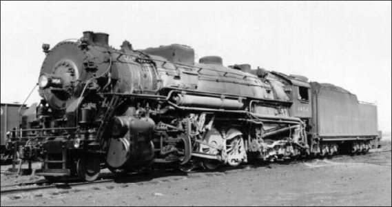

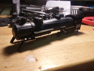

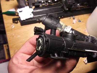

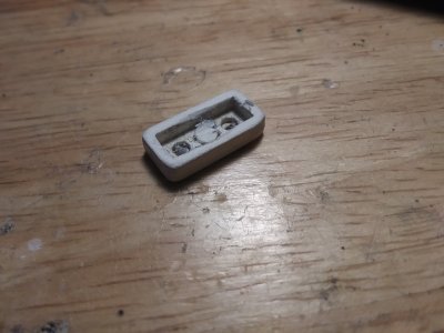

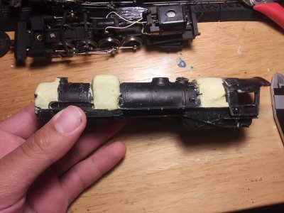

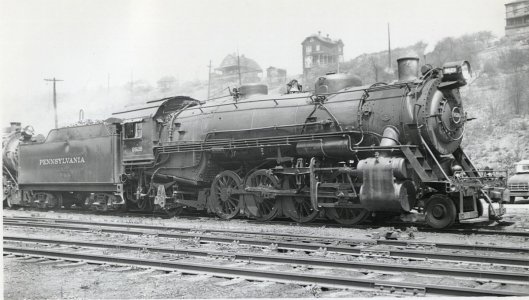

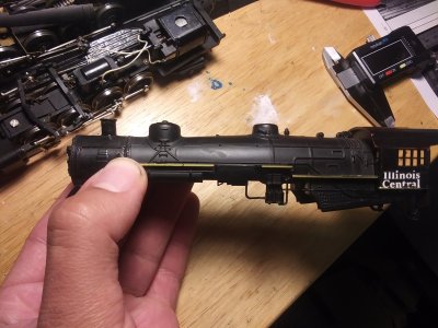

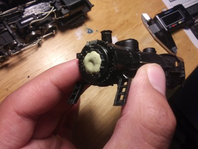

I couldn't wait! I started work already. The Berkshire will be a late Boston and Albany one, and the Mike a not so well known PRR L2! I started work on both of them yesterday. So far so good!

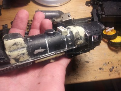

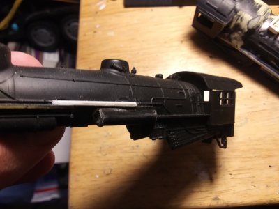

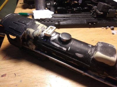

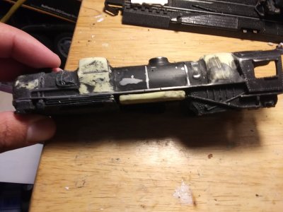

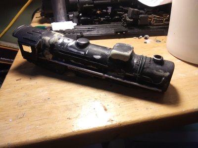

Made some more progress. Sanded down the A1 Berkshire until it looked right, and added some details.

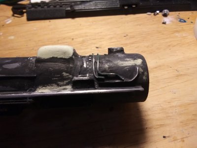

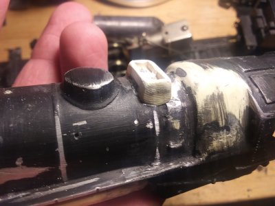

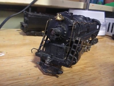

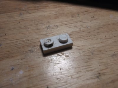

Also added a few need changes to L2 Mike. They are both almost done. Gave the Berkshire a tune up, and will be doing the Mike shortly.
