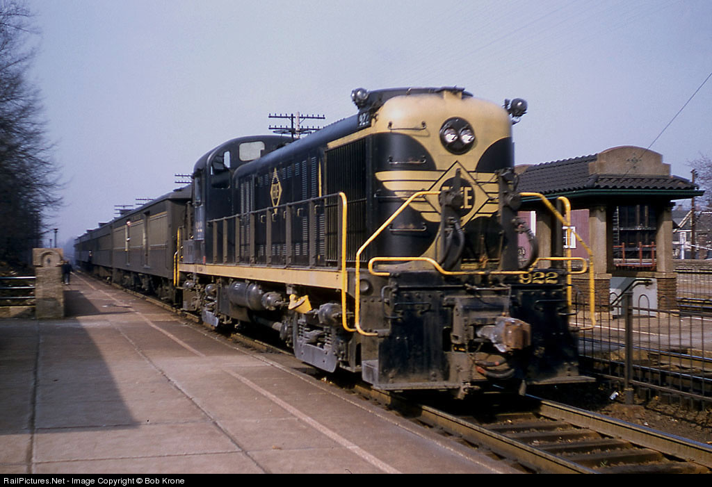

I am in the process of stripping a Proto 2000 of it's original Union Pacific colors in excahnge for some Erie paint. Stripped off all of the railings, details, windows, and was even able to break the shell back into it's original 3 pieces
