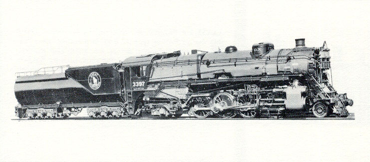

Those older Bachmann's are usually pretty good running engines although noisy, as you have discovered. They had decent detailing for their day although that tender is completely wrong for a UP 2-8-2 as is the engine, since the UP never had any locomotives that had Belpaire fireboxes. The GN did have 2-8-2's with Belpaire fireboxex and Vanderbilt tenders that sort of look like that engine and, with some kitbashing, can be made into a pretty good model of a GN Class O Mike. This is a picture of the real thing to get you started if you want to try your hand at making a more accurate locomotive:
The Bachmann engine is a reasonaly good model of Reading's Mikes although the Vanderbilt tender is wrong for it. You could replace the tender with a coal carrying square-type tender and then relettering it for the Reading.
I think I'll just retire it to a display case as-is. I don't know how something that ugly, with the motor showing out the back of the cab, could be attractive but I like it. It's a hard working little engine.
