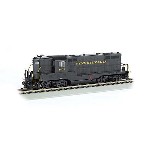

Here is a picture of the Bachmann GP7 DCC locomotive I bought a few months ago I suspect you will like its paint job.
