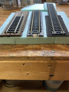

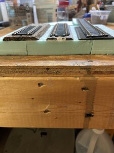

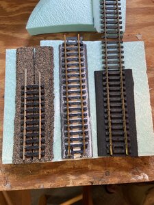

I've found the solution to my quest for a roadbed to use for a short line operation. The attached photos - not professional, I know, but I think they suffice for illustration - show 3 different options; cork HO scale, foam N scale that's been split to 1 1/2" width at the base and the gap filled in per santafewillie's suggestion, and the Rapido branchline foam with some old & scrap track laid on top of each to show perspective. The Rapido has the same base dimension as the cork but is 2mm high as opposed to 5mm for the cork and 3mm for the N scale. The Rapido foam feels as good as the Woodland Scenics foam, and since it's a Rapido product I am confident the quality is good and the roadbed material will last a long time.
