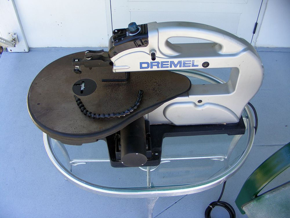

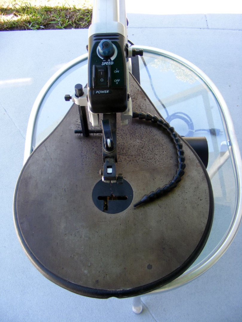

I was cleaning out and reorganizing a storage shed I have out back, and I ran into this Dremel saw, that I term a scroll saw,..and in fact that is what Dremel calls it.
It appears to be new. I have forgotten where I picked it up?
My question is how useful are these saws for model railroaders??
