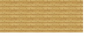

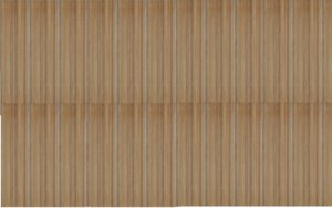

Here's an image I made from the site by mashing up multiple copies of the same image and then reducing it so the planks scale to somewhere between 6 inches and 1 foot in HO scale. I assume the planks should run horizontally, and not vertically as they are here... I'm switching this to just a thumbnail image because the website from which I got the images (for free, legally) has restrictions on distribution, and I don't want my having posted here to be interpreted as distribution not in compliance with their requirements.

Here's another example from a different set of wall texture images. I think I like this better. These planks scale to about 9 inches wide.
I decided to download a different plank image and try it out. I think I like the look of it better,

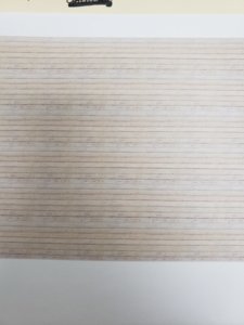

but upon printing it out and roughing it in to the inside wall..... well, I think my printer might need new ink. These planks scale to about 10 inches the way I printed it out. I'm leaning toward this one, but will need to reload the printer ink first!
What I like about this last one is that it actually LACKS some of the detail of the previous one, which is so sharp it's easy to see that it's the same image repeated over and over again.
Looks good to me, Erik!
Thanks. I will pick up some new ink -- printer says it's low both on color and black -- from Office Despot tomorrow and do a fresh run for real this time. I've also been looking up what adhesive to use between paper and styrene, and the consensus seems to be rubber cement. So I'll probably pick up some of that, too.

I've printed out a version of the one I showed immediately above, this time with better ink, and I think it will do the trick. The photo below is of the paper printout. I'm hoping tonight I can take the time to fasten it in place. I like the idea of spray adhesive... Will pick up some hopefully later today and move this forward. Thanks for the tip, Greg!
In case anyone is interested.... the site textures.com has a lot of images of all kinds of textures. If you register (for free), you can download a limited number a day, and there are other kinds of restrictions on your use and dissemination of them. Generally what you get are just small segments, so to create larger images like the one I used you have to go into Paint and then copy and paste to assemble them. (You want to use the images labeled "seamless" for this purpose -- they have been already manipulated so that people can select, copy, and paste, then match them up side to side and end to end, and they match up in color tone, shade, etc. so you don't see the borders between segments.) Once you've done that you also need to resize the images to properly scale them -- I just do that in the Paint program that's bundled with MS basic Windows. You also then have to make sure that Paint prints them out in the same scale (instead of, say, shrinking it to fit a single sheet of paper). Image below is just thumbnail size, but as I mentioned earlier, I got the planks to scale to about 10 inches wide in these printouts, and a search leads me to think that for interior wall planks that is a plausibly accurate size.
