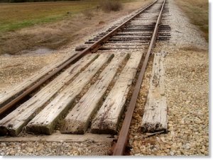

I guess it depends on what type of road you have, I have a lot of rural gravel small town stuff and saw this picture on the internet:

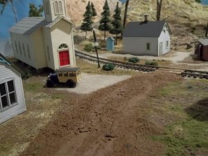

I was going for something similar whin I put this in:
