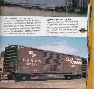

That aside, and only if you are a very devoted Grande fan to boot, would you realize one major detail is wrong about that car*...a true nit...
[*hardly an error to be laid at your door, as I'm sure you are simply focused on weathering a model you have in hand. You didn't design it]
...but that car was built and delivered in 1967, and the federal ban on equipping new box cars with roofwalks went into effect in 1966. Trivia really, except for those focused on modeling a specific year or era, regardless of the railroad, in which case it would apply there too.
As it happens, one of my D&RGW reference books actually has a photo of that specific car, #65244. I can post it if you like, so you can see how you did. Let me know. I'll try to remember to check back in again a time or two to see.
[Spoiler alert: "Yuh done good," as with all the others I've seen so far. Your methods work very well, and you've got them down pat]
One other general note, and FYI/FWIW: The "flying Rio Grande logo" came into vogue right about that same time, so this car has to be one of the earliest to wear it. I THINK there was a something of an inconsistent introduction to it, as some of the new SD45's were delivered later on, but with the older logo. Thus your followup D&RGW car, the 60' high-cube boxcar, would also be one of the earliest to sport it too.

Doh! Now I get it. Two different sides, and, yes, I've seen that on any number of freight cars over the years.
I'll scan that pic in later today, and one of your sixty footer as well. I might even throw up a couple or three more in a separate post, as I've wondered (since I first saw your cars) just how YOU might handle a certain rust situation.
[I claim fair use]
I only have this single photo of the one side, so your guess is as good as mine about the other.
I will also post a photo of the 60' high-cube in your "Speed Weathering" thread, as it pertains to that car.
