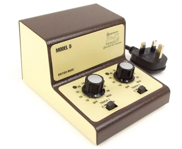

Now I want a dual dc controller. I'm looking at the tech7 but something used would be fine I think. A couple of Bachmanns would probably be fine. What do you think?
I do not know about other controllers, but here in the U.K. I use Gaugemaster controllers.
I'd go with two separate controllers. If one of them shoots craps or otherwise starts acting up, at least the other one will still work.
Not necessarily so with a dual controller, I'm thinking. I could be wrong on this, as I am not an electronic wizard by any means. 😞
This brand new is about $150 if you can find one in the US.
Go with MRC. The Bachmann power packs won’t last long. Please test it before buying it used. If the dealer won’t allow you to test it, it’s probably junk looking for an unsuspecting buyer.
I don't like the dual controllers because the amperage gets shared between the two, and most often changing the speed on one impacts the other. I would say two separate controllers.
