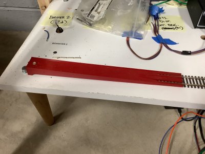

Here’s another hint. I store mine on my programming track. I set a piece of dowel on the board to locate the rerailer.
