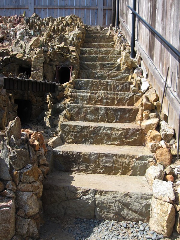

First off, in January I tried an experiment to improve the appearance of the concrete stairs at each end of the layout. When originally built, I used crumpled foil sprayed with Pam to apply colored mortar to the stairs, giving them a stone-like texture:
But I wasn't very happy with the color. So this year I brought a couple small stones to Home Depot and had some paint made to match. Then I used these paints, plus mixing in a few other shades as needed, to make the steps blend in better with the real rocks. So far I've only done the steps at the west end. Here's how they look now:

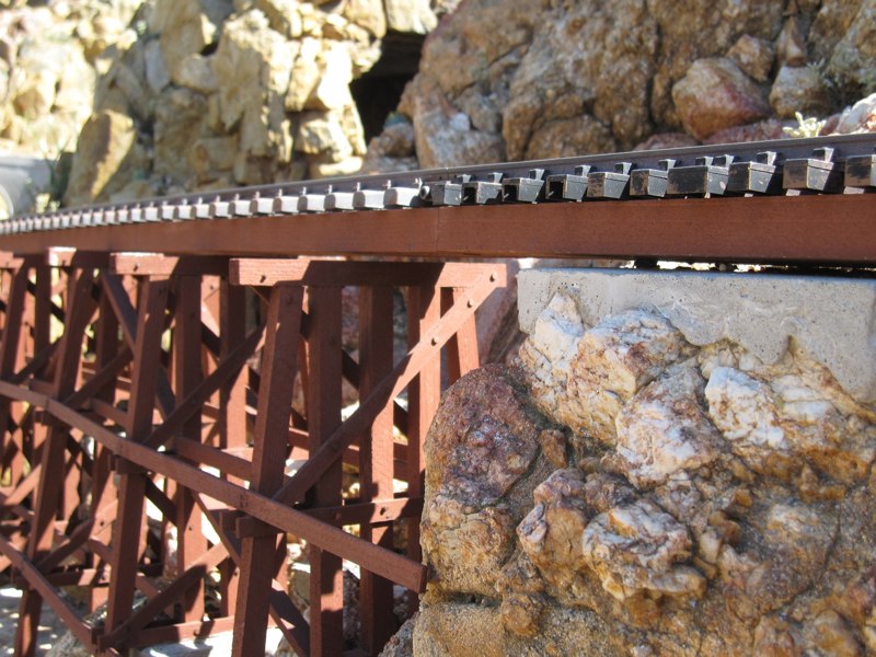

There is a long trestle across the front of that mountain, and some of the bents shifted downward along with the mountain, giving the track a slight rollercoaster effect. I unscrewed the stringers from the displaced bents to restore the smooth grade. I still need to insert some shims between the stringers and the tops of the bents.

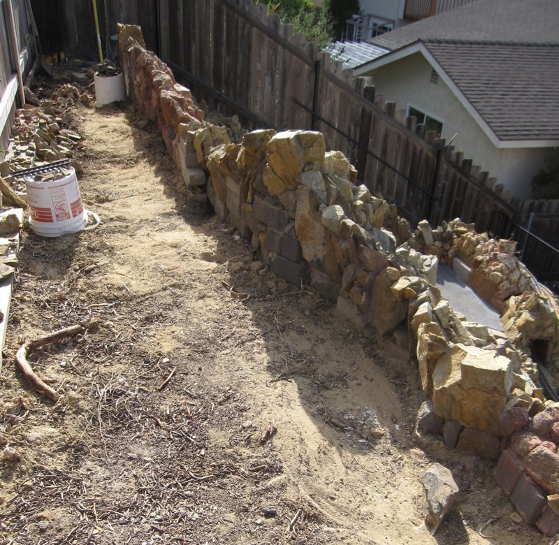

Along the bottom of that same mountain, there were some areas of rock that was mostly dry-stacked. Here's one example:
It was stable but I didn't like the appearance, so worked on that for a while, filling the gaps with mortar and thin rocks. It looks much better now, and will probably hold up a lot better too:

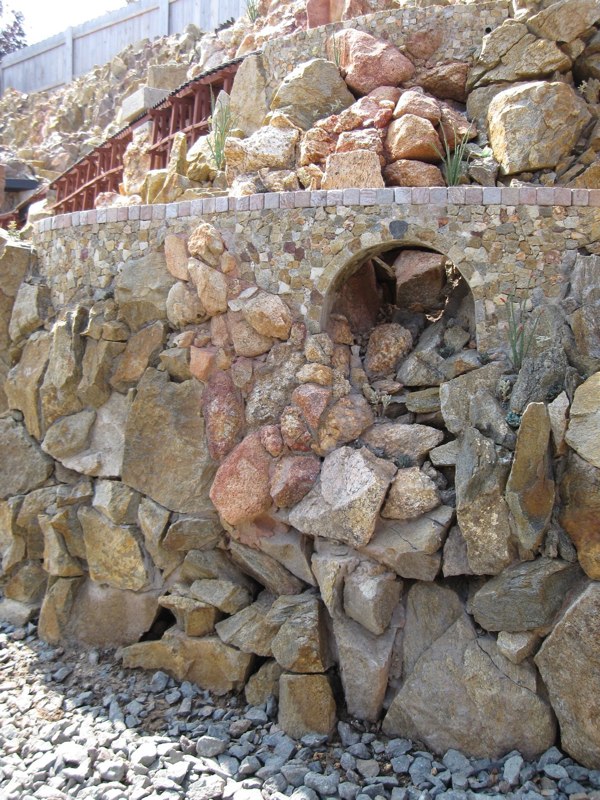

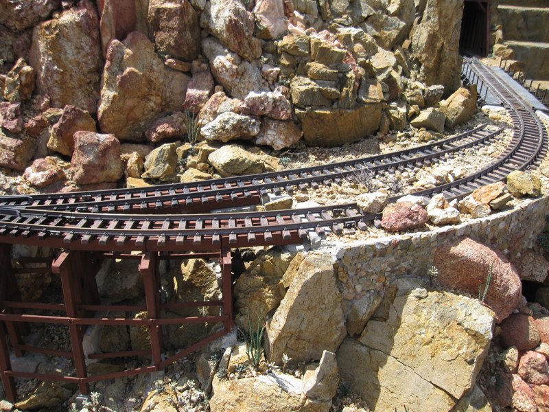

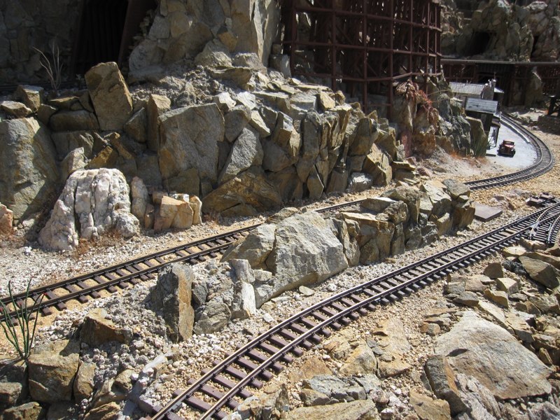

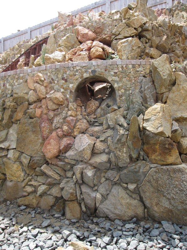

Here's another area where I made some major changes. Originally the base of the cliff here was farther back from the tracks and consisted mostly of random, loose rocks. I built up and refined it, and then added a ridge of rock between the tracks. I don't have a "before" photo, but this definitely looks a lot better now:

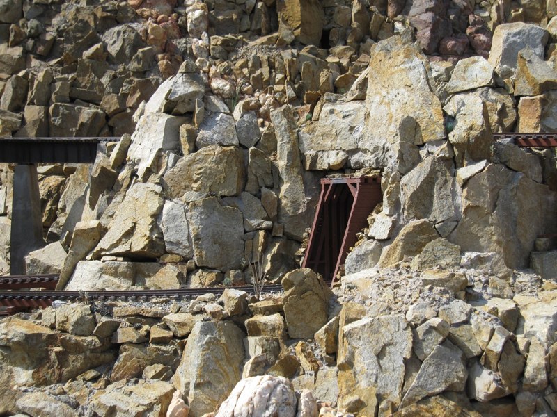

Parts of that same cliff, near the track coming out of the tunnel, also needed some work. This area was one of my first attempts at simulating a solid, sheer stone face, and I was never happy with it. It looked too disjointed and had large gaps between the stones:

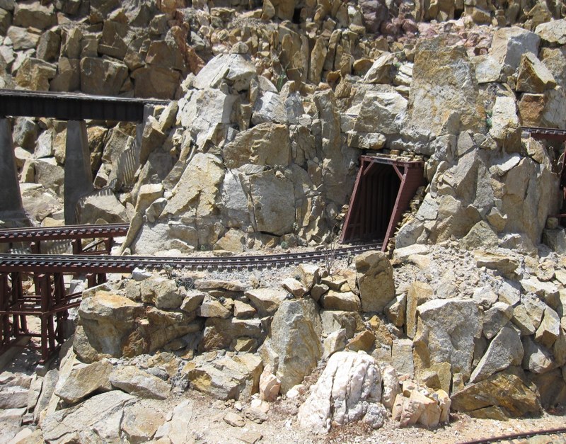

I filled in the gaps, added some stone, and got it to look more presentable:
I did the same thing around this tunnel, and also rounded the top of the tunnel opening:

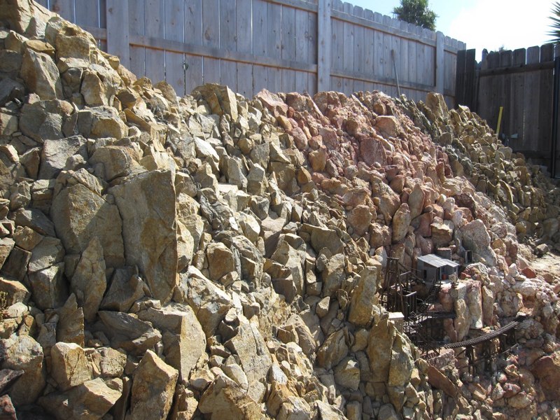

The biggest project so far this year has been to increase the height of the big mountains on the western half of the layout. I did a little of this last year but wanted to go much further with it. Here's what it looked like at the end of last year's project:
And here's how it looks now. The top of the cliff is up to two feet higher now:

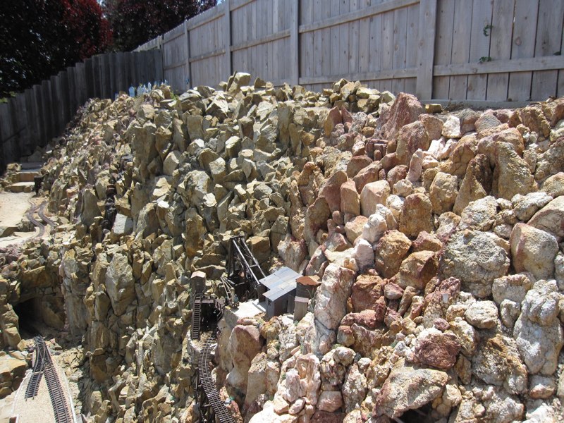

Another "before" shot, looking east from the west end:
And "after":

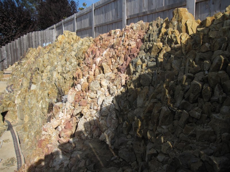

Here's a view from the top of the hill, looking west, prior to increasing the height of the mountains:
And here's how it looks now. I still need to do some work to the backside:

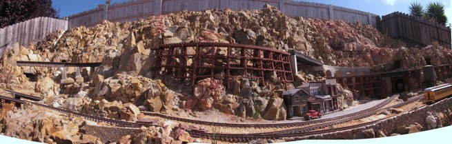

One last thing... today I experimented with "stitch" function on my digital camera, and put together a panoramic view of the layout:
Here's a link to the full-sized image. It's a large file, about 5.9mb:

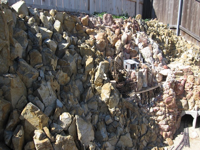

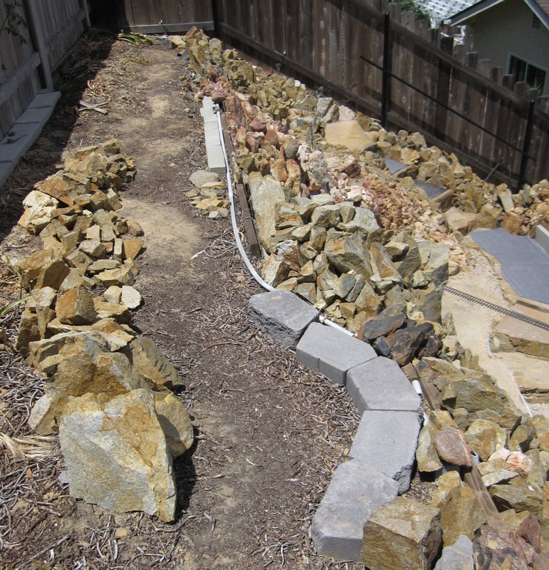

One reason I wanted to make the mountains so much taller is to provide a little "wall" along the top of the hill. As it was before, I was worried that I or someone else, might take a misstep and go over the cliff.
I'm planning to level out the path, add some gravel, and plant flowers along the fence. And maybe next year, I'll raise the top of the mountains to match it, along the eastern half of the layout.
