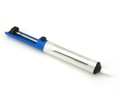

I find solder wick to be way too slow, and you'll use it up at a rapid rate. I prefer a "solder sucker," more properly called a desoldering vacuum tool.
The one I use looks like this:
You can buy one here for $5. Please note that I have never bought anything from this particular vendor. If you perform a Google search for solder sucker, you will find many versions from many vendors.
You may still want solder wick for final cleanup, but the solder sucker will remove most of the solder, and you won't go through nearly as much solder wick. The solder sucker can be cleaned out and re-used indefinitely. Mine is more than 20 years old and still going strong.
