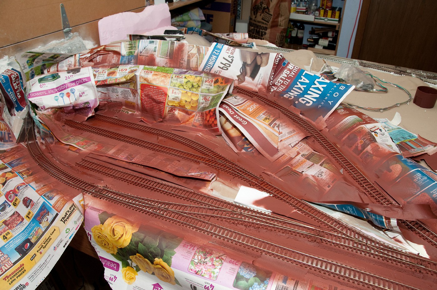

here is rustoleum rust primer. bit to flamy buy it self but s good base coat. acrylic sticks much better to it then to bare rail.
initial
toned down with black wash

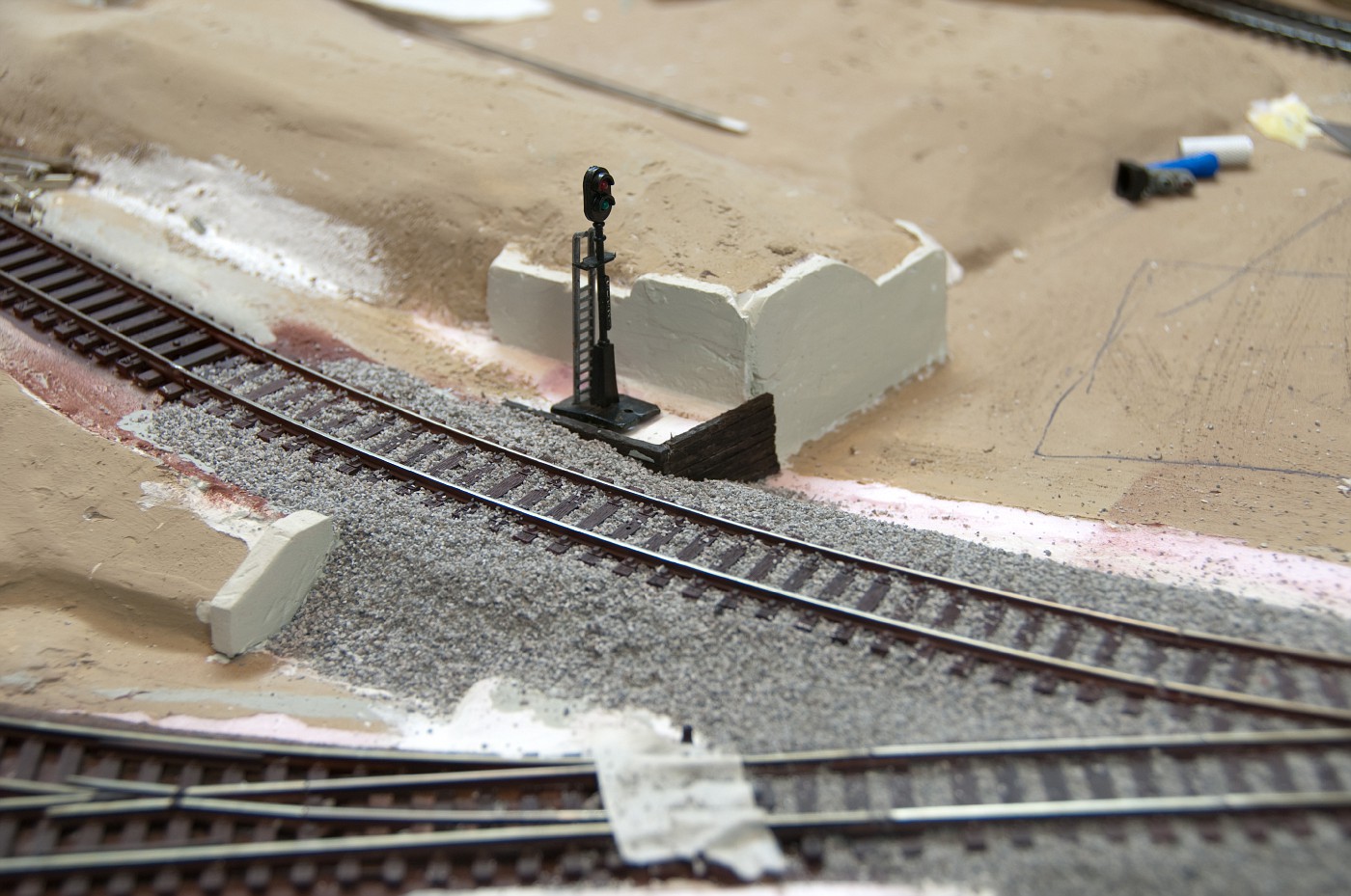

I use Krylon Camo Brown, it works well so far has not eaten anything and dries fairly quick. It is a flat paint and sprays a fairly fine mist. Almost the right colour for aged ties too. You can see it in this pic on the furthestmost curved track. The wye also contains rust painted rail and painted ties in the ripped up section of right of way...
