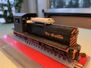

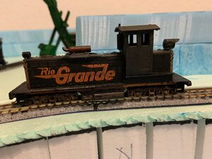

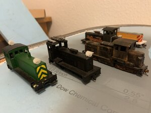

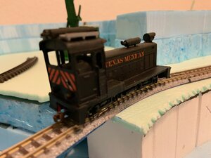

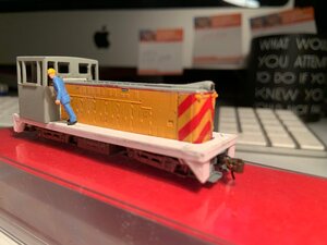

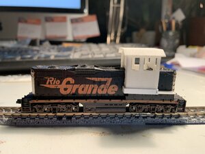

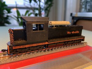

Hi, went a bit further with my conversions.....
Here are some in the works.
I love the Rio Grande Logo...so I will keep it. Is there a prototype...I would say no...but who cares...narrow gauge mining ...everything is possible....
also converted one in all black....
All of them need more details. Already on order from Shapeways.

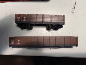

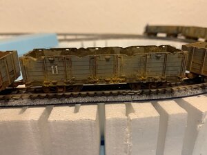

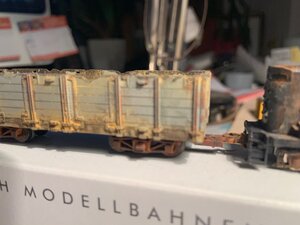

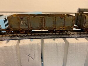

For the cars, I converted the long HOe LILLIPUT cars. They where shortened, distressed and weathered. I bought 6 of them quite reasonably on E Bay. # had the Break Stage left on, 3 where converted without.
Here is a picture of the original car body and for comparison, the shortened one.
then the distressed, weathered ones.
I will post more pictures of the Loco conversions as I go along
Cheers to all....stay healthy !
Chris

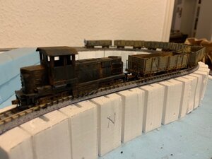

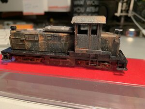

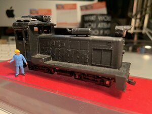

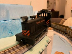

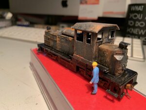

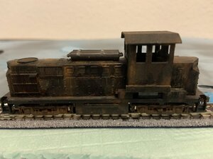

Hi there,
some more pictures of the Black One.....
No details and without walkways...and the first layer of weathering applied....

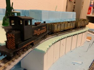

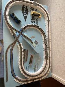

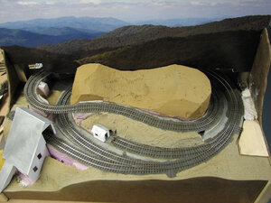

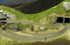

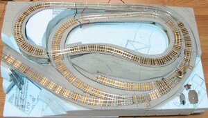

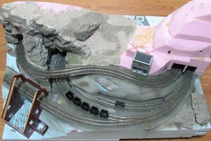

Hi,
now I like to introduce the layout.
The first 4 pictures are of the one that inspired me.
The last one is the current stage of mine....
It is 100 X 61 CM wit an elevation change of 0 to 5.5 CM . The upper siding will service the planned quarry are. The lower siding with a 30 degree switch will go to the office / oil facility and an eventual extension.But to guarantee good reliable operation I would have to use a 15 degree switch moved back to the area under the bridge.The idea is a Crusher facility with a return loop...but at this stage just an idea.....

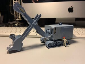

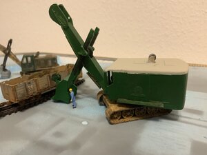

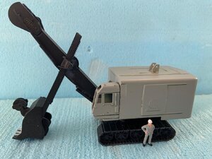

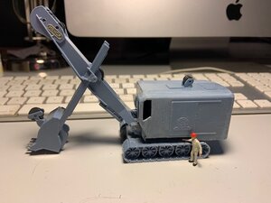

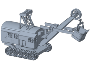

I have started on the Face shovels for the quarry.
I did want one of a bit of SUBSTANCE, but due to the space limitations I came up with a compromise.
I started with a 1 : 60 scale WIKING model as seen in the first picture. Then I changed the cab to match 1:87...with some other changes it will be small enough to fit but look large enough to show substance.
The last picture shows a UB 80 shovel. A bit smaller and it will be ,after some changes, parked as a comparison.....
Anyone looking for a great mining shove in HO scale,, SHAPEWAYS has on I fell in love with. Unfortunately a bit too big for my space.
The designer made 3 versions of the same machine as used in different times/areas. And the price is not too bad either $ 120,00
I know i am bouncing around but that keeps me from getting bored. We all have some things we totally LOVE doing and then there are the things we NEED to do.....so a bit of variety helps.
On this note enjoy and a HAPPY NEW YEAR filed with GREAT PROJECTS
Chris

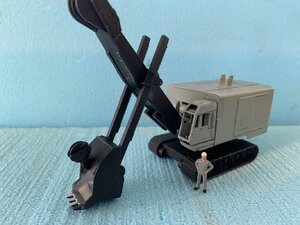

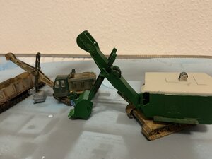

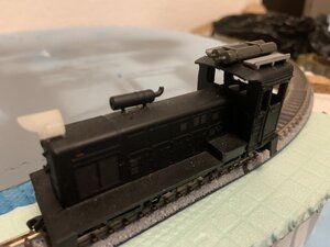

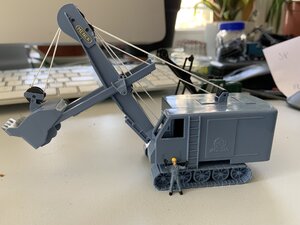

Hi,
First of...A very HAPPY NEW YEAR to all !
Ok...went a bit further on the Shovels.....Now the finer work begins...
And for the Locos, the parts I ordered in the States came the last day of the year...
And I attached the Air Tanks to the 2 black ones.....now they need the air lines etc and some other details.
Until soon.....

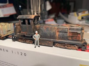

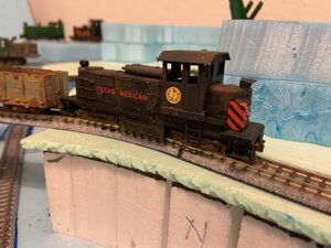

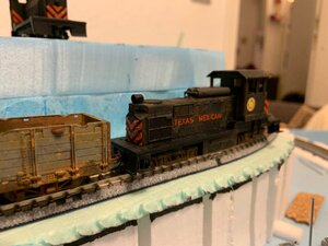

Hi Rico,
appreciate it ! I went a bit further along. I got my Decal Sheet from MICROSCALE for the TEXAS MEXICAN RR.
The primary reason for the Decals, It had enough Logos for quite a few Engines and it loosely fit my Layout idea.
A South Western Mining RR on border, that works both sides and thus would allow foe modified European rolling stock....
So here we are.....
Now more detail is needed...like Railings etc.....and of course weathering and heavy use distress.....
enjoy
Chris

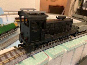

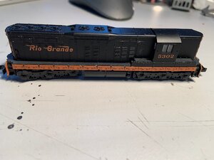

Hi guys,
well corona has a good side...LOTS of TIME......
I just got my new loco, an older KATO SD-9 a great runner and just made to convert.
So by now, she got a cut down US HO cab, Air tanks and piping and the first Running Boards....
Next are the Pilots and front and back Running boards.
i already ordered railings from the US......

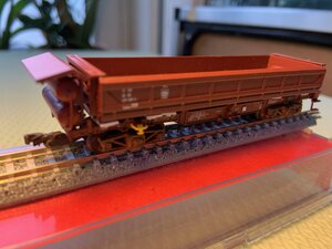

I also found something interesting in the world of TT Scale...a Side dump car....
For the guys in HOn3 all you guys have to do is change the couplers, remove the buffers and redo the platform and railing at one end..PROVIDING you do not run on tight radius curves like I do...For HOn30/HOe I has to rebuilt the mounting for the Trucks and change the trucks to Lilliput HOe ones....It looks really good so far. Once all the bugs are worked out I will build a 5 car train.

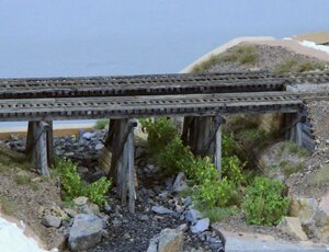

Hi,
so the switch from Japan is here.....( funny that I can get something from Japan to Germany in 10 days....but from Austria to here 8 weeks...)
I test fitted it and LOVE it.....
The wood for the Trestle and Cribbing is also in the mail......

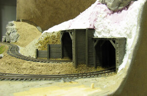

And I got some GREAT scale Stones from Hungary. Look at the picture. 100 pieces in a bag and the seller will give you a good discount if you order more than one bag !
My Trestle and Tunnel entrances will look somewhat like the pictures attached...at least that is the general idea.

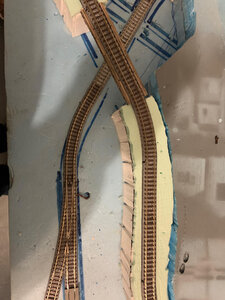

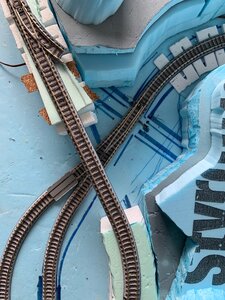

Hi,
well....the position of the switch had to change. Once the track was put down trains started to derail at the beginning of the switch.
It must have been the fact that it was right at the beginning of the incline. I moved the switch forward to the new location and now all is well in the track world.

Hi,
I always had bad luck weathering my track, or getting the track in good running order, except for my Large Scale Garden layout.....
This time I took more than great care to lay down the track and I am very satisfied with the result.
So looking at the layout the shine of the track still bothered me but the fear of screwing all up again...well it lingered....
Then a friend of mine told me about the Woodland Scenics Track Painter.
I took some and tried it....a few inches at the time always making sure the top of the track was cleaned off right away.....
I am a convert of the the Track Pen ....I rusted the track, not only does it look great but also NO PROBLEM with the running of the trains!
Now to the ballasting and further detailing of track and finishing the rough terrain....

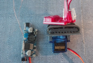

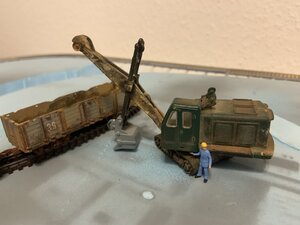

Hi,
since I am a bit stuck with the Terrain building...lack of material.....
I continued with an other Mining Shovel.
Then I found this servo unit on E bay.....
I already contacted the designer/builder, I can get a plain one to power my shovel.
In the meantime I am trying to find a way to raise the bucket through the swing motion....
This coupled with a sound chip of a quarry excavator loading should add some interest....
here it is
Cheers
Chris
