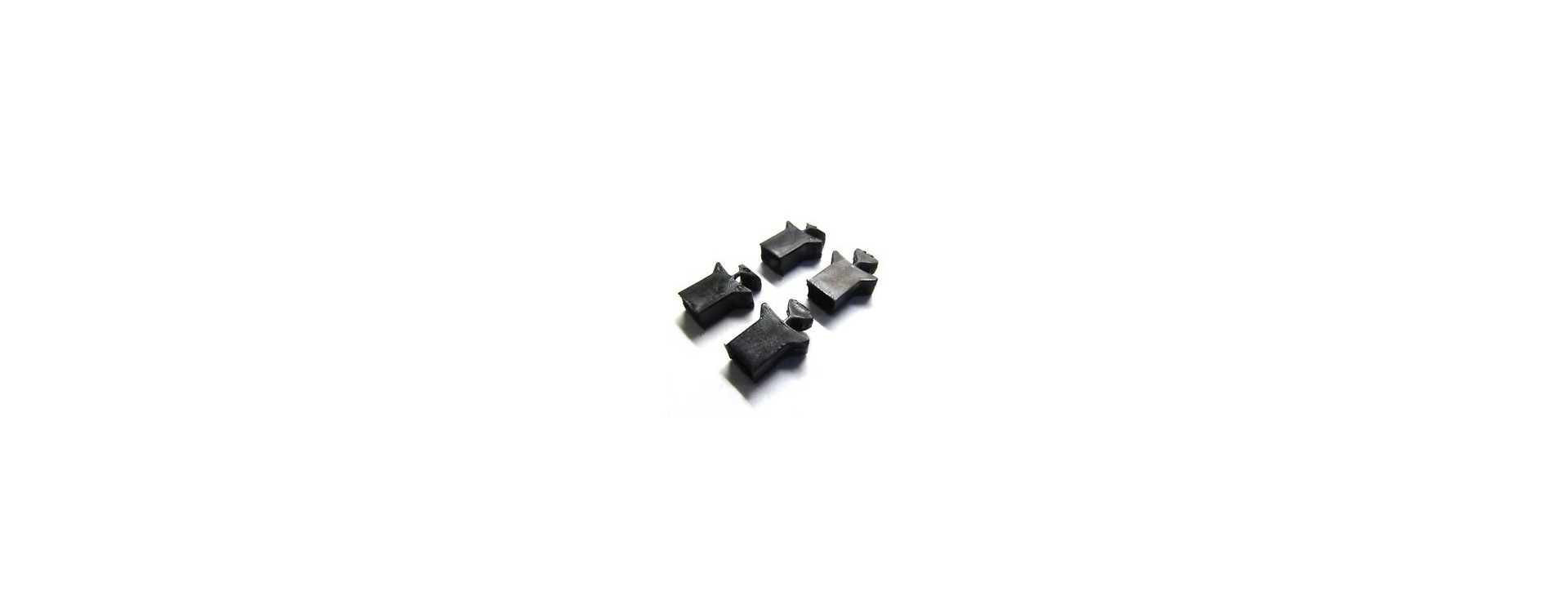

How are the Rapidos attached? Are they through an NEM box? You should be able to swap couplers easy if through an NEM box (and many are that way). (Especially the Trix stuff I would think)
Yeah, the Titchy kit is the only viable solution I can find, other than to try to kit bash one of the older models to accept currently produces 3-axle trucks... perhaps a passenger car truck would fit? Not sure I want to buy all that stuff and end up disappointed.
I don't know what a NEM box is... Please educate me
Various Googling can help you find more info. Basically a standarized system of pockets and couplers so that various brands can all work with the same couplers. I would expect at least the Trix stuff to use them, as trix is German.
Normal European Modelling Standards
It's a universal coupling system that allows you to use whatever coupling you want.
Basically it's a Kadee gearbox, which you've assembled and fitted, but you've forgotten the coupling, then you buy the coupling you want, Kadee's, tension lock etc. it allows you to swap them out, fit longer, shorter, overset or underset and you never need to take the box apart, you just pull the coupling out and push the new one in.
I can fit a NEM pocket to one of my EMD's and have it pull my UK stock, (all tension lock couplings) and 5 seconds later pull my US cars which are all Kadees.
The only downside to these is, they have a tendency to allow the coupling to droop after a while, but is a simple fix.

Check first, some brands will have their own version and are not interchangeable, also you will find, not all manufacturers have the same standard for height, or position for the coupling so it's a good idea if you are making a rake to have all the cars from the same brand, or you may have to fiddle with some of them so their all the same height etc.
