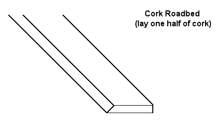

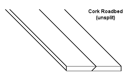

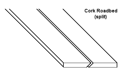

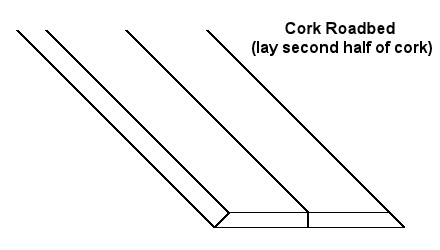

When you split the cork down the middle, you end up with a beveled edge on each of the two pieces. The beveled edge goes on the outside edge of the track, giving your roadbed a sloped profile, which is more realistic than a flat vertical edge.

So you start with the unsplit cork out of the package:
Then you split the cork down the middle, giving you two beveled edges:
Then you lay one half of the cork:
Finally, lay the second half of the cork:

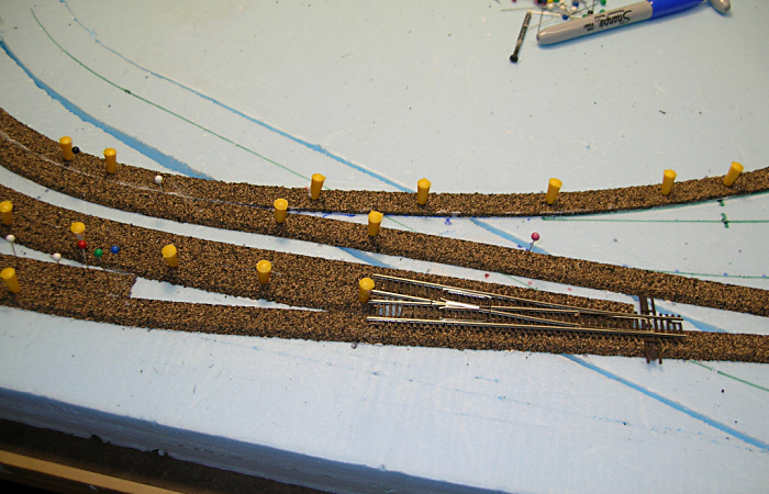

I use cheap latex caulk to glue the cork to the subroadbed. I use pushpins to hold the cork in place while the caulk cures. Then I glue down the other half of the cork.
