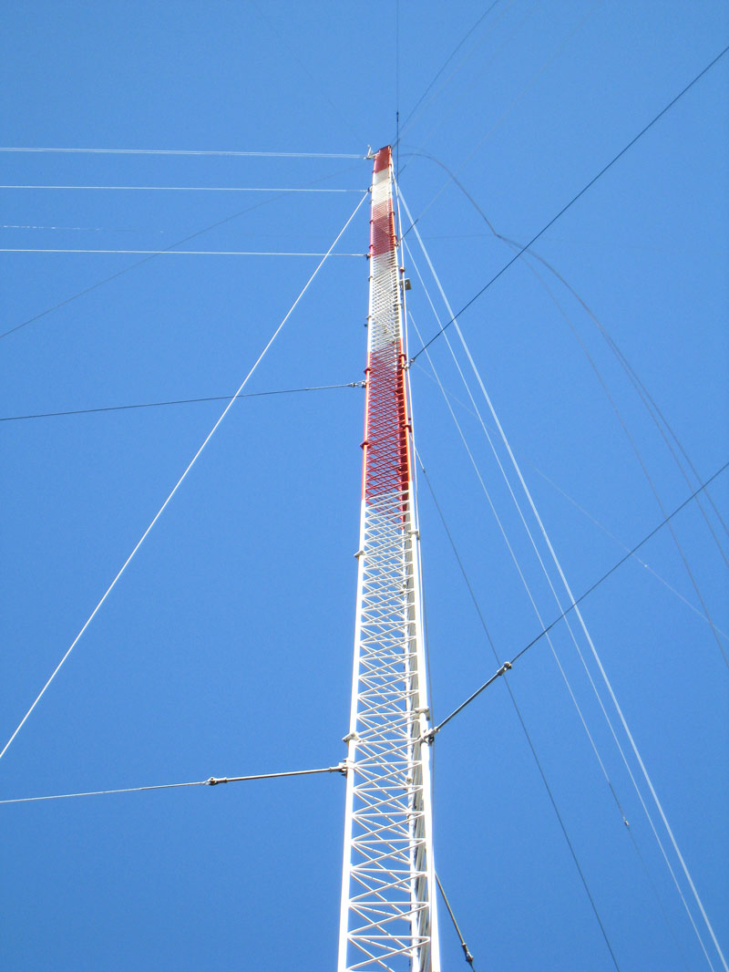

I'm trying to find a china cabinet to hide my Ham radio tower behind so I can hide it while I play with my trains....
