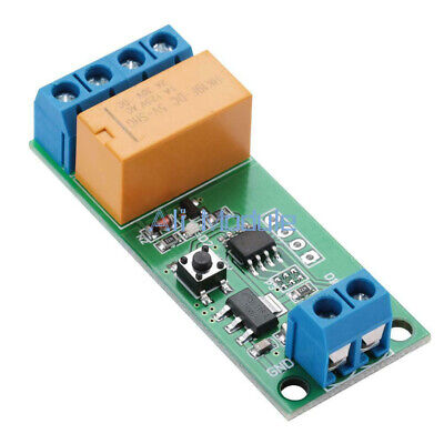

Can I ask why you want it that way instead of getting yourself (for example) a DC engine and cheap controller? I don't know much about that arduino stuff but you could probably make something like an auto reverser for each end of your section of track.
Interesting!
So I would have to open an actual Locomotive engine model and hack the power leads into that board? I'll hunt around for some videos on that board in action.
I was over thinking it with the battery and wifi, obviously if it's just a simple back and forth it doesn't need all the.. ahem.. bells and whistles. (sorry)
Cheers.
@Smudge617 Ah, the only problem with that module is there's no speed control. Let me know if you have a link to one with speed control (I'm talking real slow) as I'm going to look for one myself.
I think you'd need to add IR switches to this, but I'm not sure.
