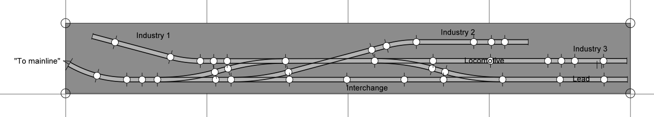

I'm getting back into the hobby after a few years and looking to build my second permanent layout. I'm currently living in a small apartment and 6" x 48" is about the most real estate I have available, so I've decided to construct an N scale micro layout to operate on.
My previous layout was a childhood-built HO 4x8 tail chaser, and I've not designed a switching layout before. Through some research plus trial and error, I sketched up this Kato Unitrack track plan serving 3 industries. Basically, the layout would be "staged" on the interchange track by an imaginary train from off the layout with 3-4 cars, which would be switched by a local switcher, swapping out various cars for empties at the 3 industries with 1-3 car spots each. Not every car would be switched during an operating session.
Does this feel too ambitious for the space provided? I feel like I could definitely just go with a simple (and fun) Inglenook in this space, but I'm hoping for something with a little more operational interest/prototypical fidelity. Any feedback on the track plan would be appreciated from those who have built and operated on switching layouts before, especially if I've made any glaring errors.
