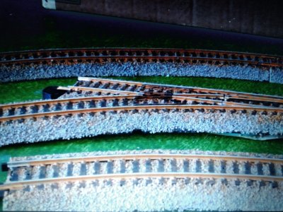

so as suggested in the other weathering topic. here are my weathered tracks.
still a work in progress, and not finished yet.

I took some nutmeg brown and burnt umber and blended to a rust color similar to that in the picture, I used a small brush and applied to the ties and track and wiped off the top of the rails. It turned out better than I thought it would. After the ballast was applied it looked even better.

You have flexibility in color choice; a dreary gray day will result in the rails looking dull and gray. A brightly lit day will have things looking a bit more brown. If you want to depict newer rail, (say, a newly added siding) it’ll have a fair amount of orange to the color.
In the ....Layout Design and Construction..... area, I have posted......."First time ho layout".....
On post #20 I have ......pictures...... of my painted track rails inside and out. I used a tiny brush to paint the rails by hand.
It was very time consuming, but that's how I did mine.
I also did the ties, to make it look like rust from the rails.
Better pics. on original post .

I painted some of my track with a brush on earlier layouts, I think that yields premium results.
Dave LASM
I have been meaning to add a photo of my finished painted track. The track and ties were spray painted with a can of automotive primer after they were fastened down to the road bed. The mainline was ballasted with a commercial ballast, and the siding was finished with natural sifted fine sand.
Here is how they look, no additional paint was applied other than the base coat of primer:
After applying the spray of primer, the top of the rail was immediately wiped dry using fingernail polish remover (Acetone).
A different method used on previous layouts, and for detailing, is the tidy track paint pen. Here is how that looks:
The top needs to be wiped clean with this as well, and the tie plates can be cleaned up as well some. It is not very precise but has a realistic rusty look. Is much more time consuming than the other method.
