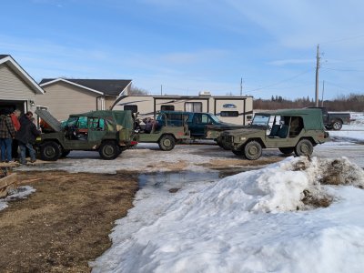

Been a long time since I've seen a Bombardier Iltis. "Banged up" more than one of those in my day. Personal ownership or a picture from a..... "previous life"?
The Iltis is one of my toys, great fun here at the beaches!
There’s actually four of us on my street with them.
