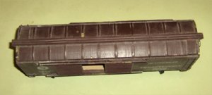

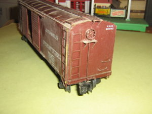

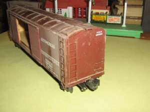

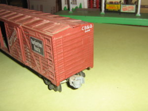

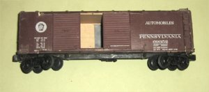

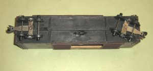

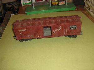

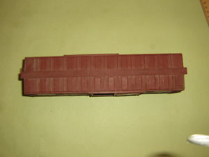

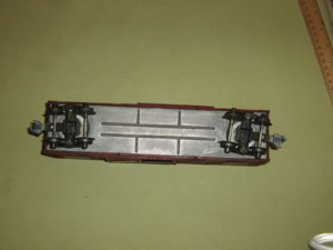

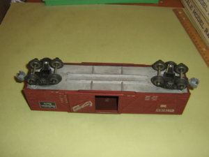

I have some freight cars I am trying to sell, but I am not sure if they are O-Scale or Lionel. Is there a difference? Can you tell from the trucks? The wheel-span appears, on these two cars, to be slightly less wide than some others which I know are not Lionel. And the knuckle couplers are much smaller. But these cars don't say "Lionel" on them, and the Pennsylvania, at least, appears to be kit-built. I don't want to be selling someone an O-gauge car and then have it turn out to be a Lionel... Thanks for help...

The Burlington stock car is Lionel.
The Penn car is a kit, but I cannot recognize, the wheels have a lionel look to them, but the frames and couplers do not?
Lionel is a manufacturer.
O is the scale, of which there are many manufacturers. Lionel is the largest producer of O.
Lionel makes both O and HO, but they (Lionel) are widely know for O. Lionel has made predominantly O, but has made and is once again making HO products.
I was under impression that O-scale and Lionel were incompatible, that the O-scale cars would not run (work) on Lionel, because the wheel width is different...
I had a friend once who was an O scaler, and he took great pains to point out to everyone that there is a big difference between O Gauge and O Scale. Your cars look to be either Lionel or Lionel compatible. Wheel profile (those Pizza cutter flanges) is a dead giveaway. Also look for one wheel being insulated on O scale wheelsets, where Lionel would not be (unnecessary because of that third rail). Talgo couplers are rarely seen on O scale stuff. *Edit* Some early O scale did use an outside pickup before two rail became popular. There was a wiper on the locomotives that contacted an outside the track conductor. I'm still betting Lionel.

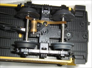

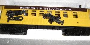

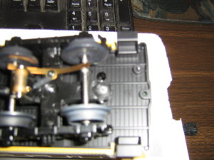

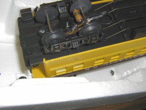

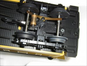

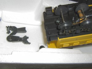

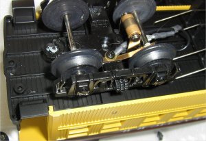

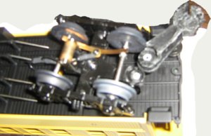

Thought I got a great bargain on 3 of these these Lionel-compatible passenger cars, at the auction, until I got home and discovered 4 of 6 couplers were broken. The truck-couplers appear to be of pewter or some pewter-plastic combination. If you ever see any of these Rail King's for sale, be sure to check the trucks!

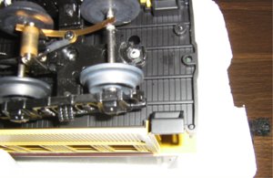

More (better) pictures (from previous message) ...Anybody have any suggestions on what to do with these guys besides wrap them up for Thursday morning trash pick-up? :)

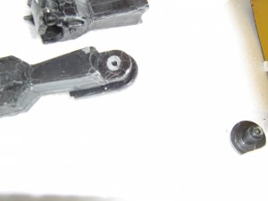

I can't believe how brittle the pewter or whatever it is, was. The coupler crumbles apart when you put small pressure on it. Maybe there is some corrosive chemical in the air in my house. If so, the Coronavirus doesn't stand a chance!
I thought about measuring the distance between the rails, but there is an easier way. The wheels made of metal must be isolated from each other. It is harder to do if the truck is made of metal.
The couplers are aging, over 40 years. One picture shows hair line cracks all over the coupler.
They don't if they are running on three rail track because both outside rails are the same polarity, so the wheels and axle can all be metal. They only have to be isolated from the center rail roller, which as you said IS harder to do if the truck is metal.

At any rate, the cracked/broken couplers are suffering from a malady commonly referred to as "zinc pest". It's a result of poor quality control on behalf of the actual job-shop manufacturer (Chinese, for the past 30 years or better) who has allowed impurities to get into molten zinc metal before it is poured into the molds. The parts look perfect when they come out of the molds, but over a period of time the parts will slowly start expanding, crazing, cracking, crumbling, and disintegrating. The time period can vary from what I gather, maybe anywhere between 6 months to a year on up maybe five to ten years or so before the first symptoms start appearing.
In this particular case, probably the couplers on the entire run of these cars are affected. I've seen and heard of other parts being affected too. Side frames on diesel trucks, passenger car floors, various steam tender parts, entire locomotive shells, etc. etc. And not just confined to MTH. Lionel, Atlas, K-Line, and probably all the other well known companies with Chinese-based manufacturing have all had these problems at one time or another with various batches of die-cast parts going bad over a period of time. Bummer. 😡👎
