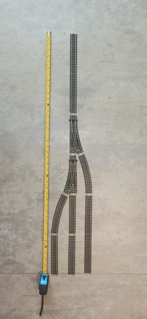

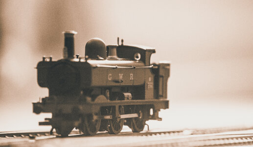

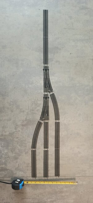

Anyway, long story short, I came out with 4 wagons, and a Hornby GWR 0-6-0 PT 2721 '2764' as well as enough track from Steve & Dave for an Inglenook. Inglenook because I just threw the word out of my mouth whenever any exhibitor there asked me what layout I'd want to build. Photos of the plan for the future layout follow. The layout will be earnestly started after my move to Ashford this 30th. I would be very grateful to members if they can give me ideas for the scenery and other bits to make it a beautiful layout. From the tape measure it looks to be about 4'x1' plan.

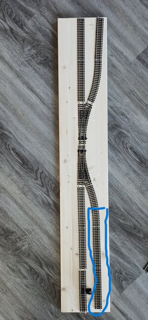

I have finally begun the build of my first layout, a simple shunting yard (ish). But I cannot get power on the track parallel to the power track (marked in blue). Also, when I throw the switch for that track, there is no power on any track forward off the point. Would be grateful for some advice (Please ignore the fact that the rails aren't connected. I placed the rails together to show the track plan).

Looks like you're using an insulfrog turnout, so power is routed in the direction your track rail is pointing to, the easiest way around is to add jumpers from the neighbouring track to the track you've marked in blue, so both will have power regardless of which track your turnout is facing. I would suggest you do the same to the opposing rail as well.
