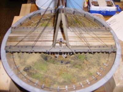

Sirfoldalot, I have wondered if I should paint the cables some rusty color? At present I am attempting to make static grass tufts to place in the Turn Tables pit, along with detailing the pit floor.
Here is a photo of the detailing of the pit floor. (Now, all of a sudden, the photo size has been reduced! Is changing the size of the photos something the Moderators are able to do? This size does not lend itself towards showing details)!
