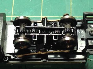

Greg, here's one of mine that did the same, Atlas Geep.
I picked it up used, I'm guessing it was running on the Shag Carpet Southern!
You didn't say who or where you bought it from, but new with wheels in that condition. I'd be very suspicious.
