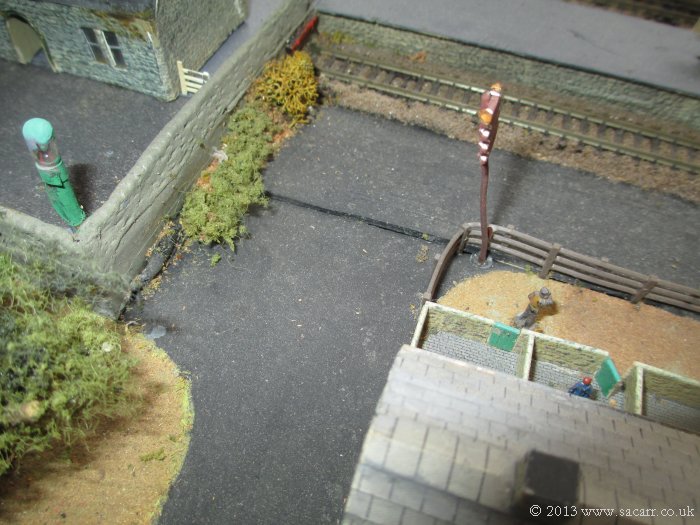

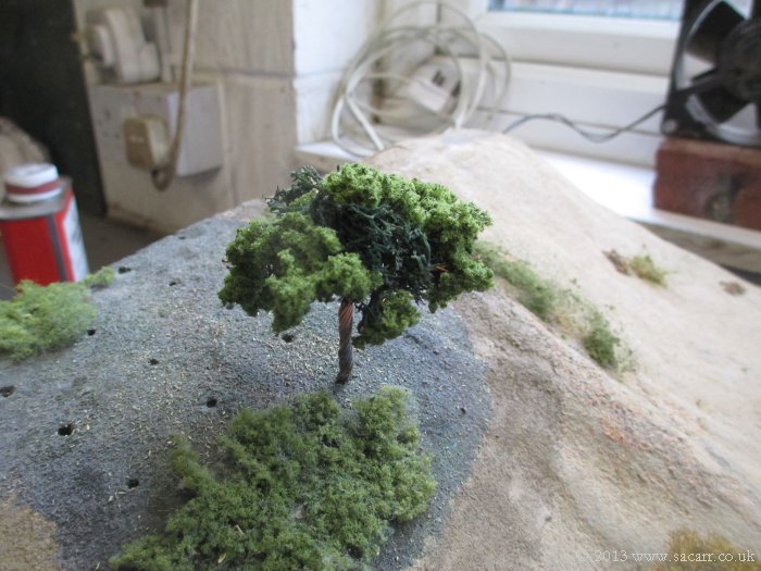

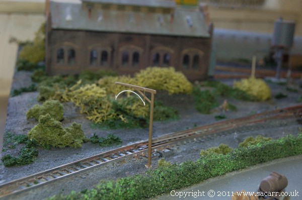

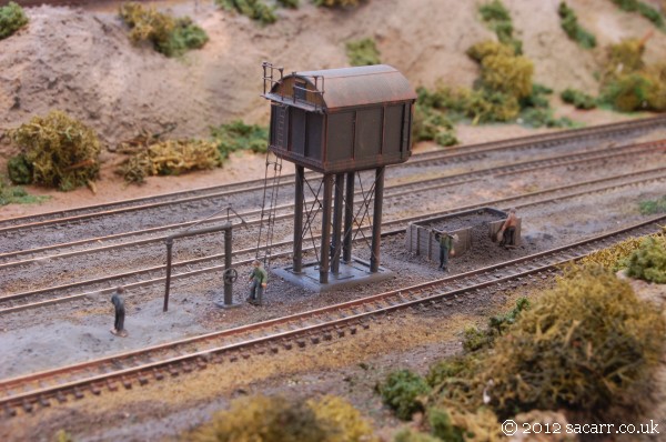

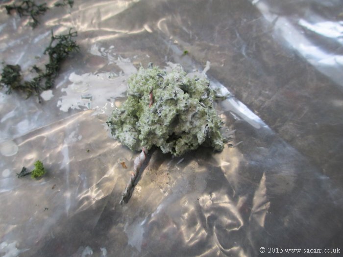

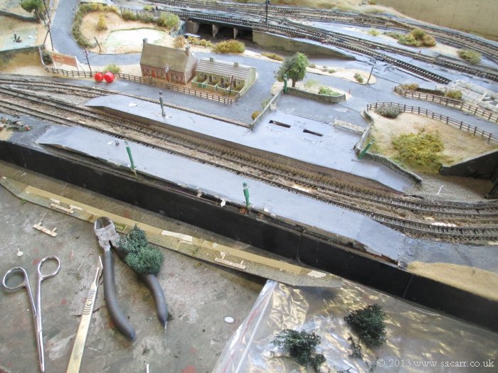

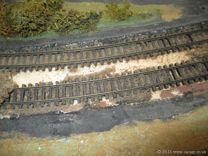

Here's a few close up views around the layout showing some of the areas that are going to be reworked. The main reason for the refurbishment was the track bed. As you can see below, the foam/sponge track bed has severely perished, with the result that the track is now uneven, causing derailments, particularly at rail joints. The second picture is from the World War 2 layout I'm working on, and shows how the trackbed should look once reworked.
The roads on the layout are all card, and there are some ugly joints here and there, so these are going to be resurfaced in styrene and will probably have road markings reverse masked before spraying the tarmac colour and texture speckling. You can also see how faded and bare the landscape has become over the years.

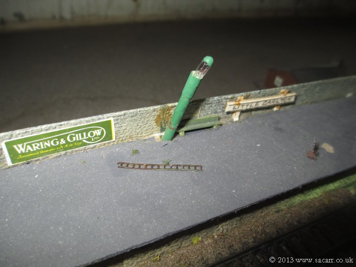

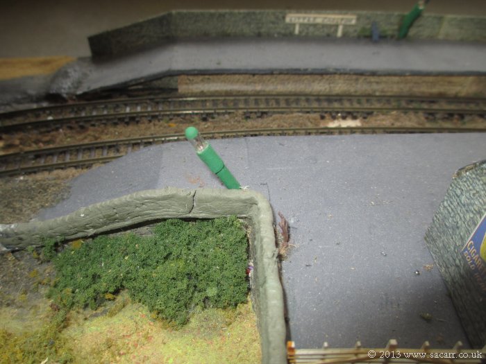

The station is also going to receive some much needed TLC. The platforms, like the road, were card, and these will be replaced with styrene. The over scale grain of wheat lamps will be replaced with LED versions, and additional platform details and accessories will be added. The platform rear wall will most likely be replaced, as the printed card version is badly glue stained, and new posters applied.

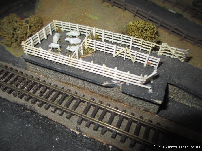

The cattle pens and goods platform are slightly damaged and need repairs. For some reason, this siding isn't ballasted. Perhaps it was replaced at some point or maybe we ran out of foam ballast! It's too long ago to remember, and I was only 10 years old at the time.

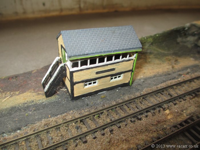

The signal box structure is ok, but the painting leaves much to be desired. That will receive a repaint.

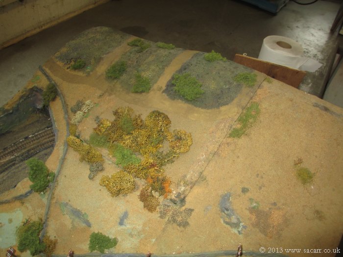

The hillside has faded extremely, and all the trees were pinched for another layout, so this needs colour and vegetation re-applying.

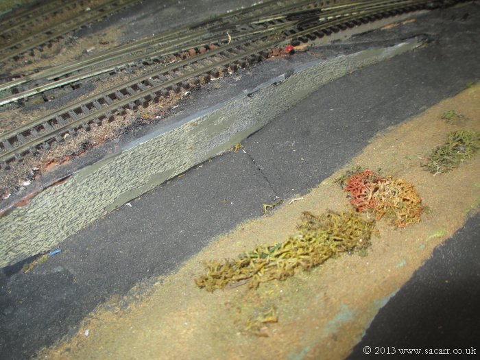

Much of the track side was painted directly onto the plaster without any surface texture ( see below ), so I'm planning on re-working these areas like on the Wartime layout ( bottom picture ).

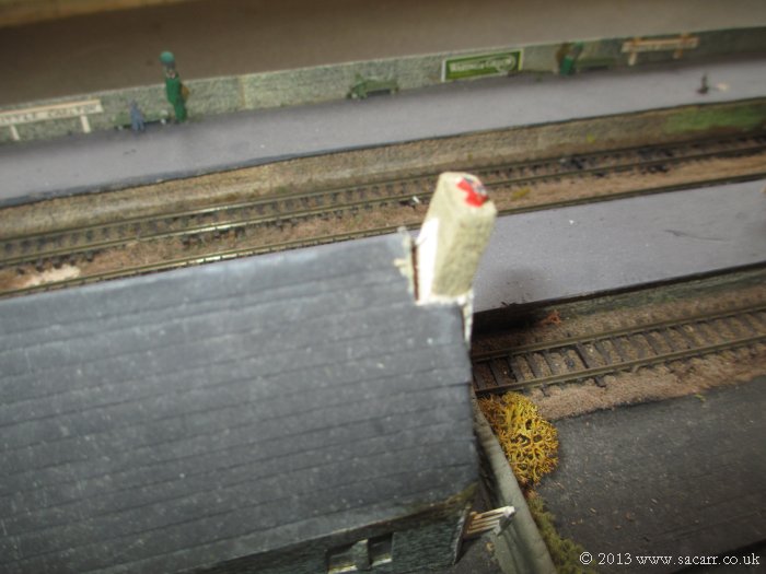

Further repairs at the station building include both chimneys, which have been knocked, so they both need repairing.

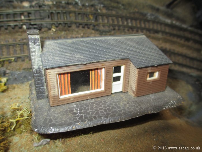

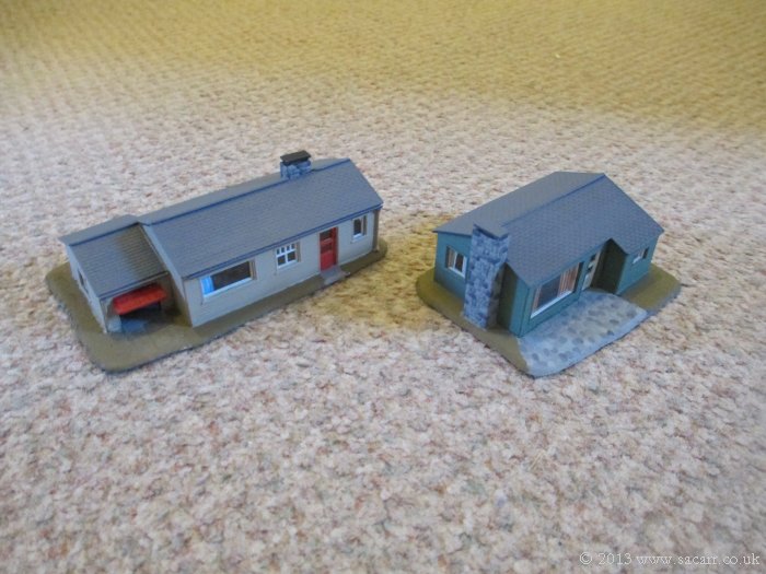

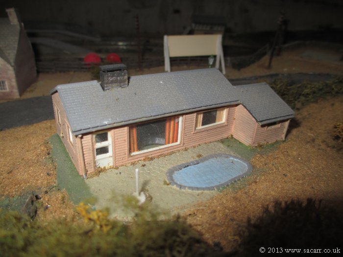

The last area that needs looking at are the two bungalows, both that need tidying and repainting. I don't know why the sprue joins on the roof were never trimmed off.

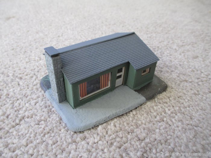

Here we go, a start has been made. This is the smaller of the two bungalows, which is part repainted in this picture. It needed a minor repair to part of the roof and gluing back to its base before the painting started.

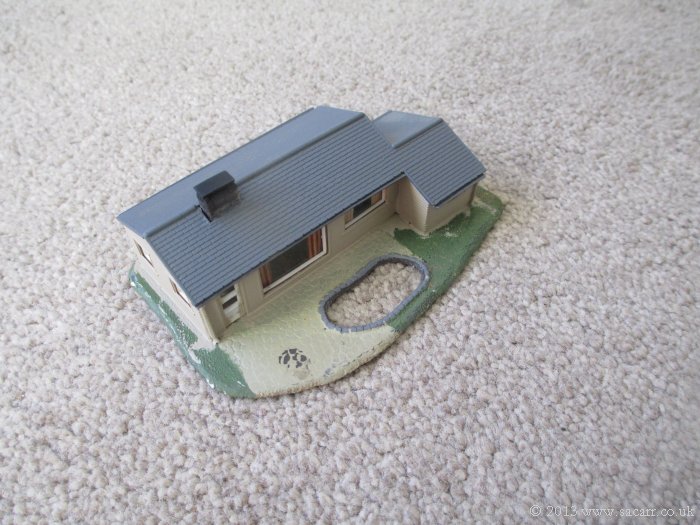

The other bungalow didn't need any repairs, but I have cut out the horrible blue painted pond. This has now had a sheet of clear styrene added below the base, and the layout will be slightly hollowed out to create a more realistic pond.

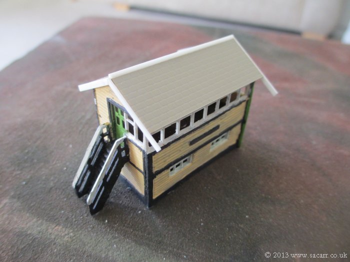

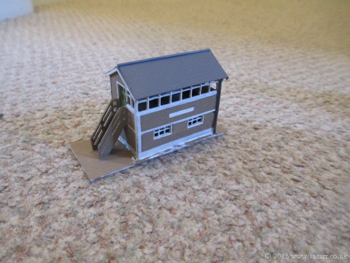

The original signal box was removed, as was its wonky roof. This was replaced with new styrene, along with a new ridge and fascias. The signal box was also glued to a styrene base to allow a better gluing area for fastening to the layout upon completion.
The three buildings part painted, waiting for the paint to harden before further work is done.

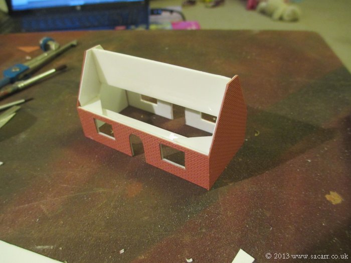

The original card station building was in a poor state when it was removed from the layout, with peeling stone paper, bowed walls, glue marks plus the existing damage. I decided I couldn't make a tidy job of repairing it and so set about making a copy in styrene.
Most of the building complete, awaiting paint and glazing.
The bungalows are now complete, except for their gardens, which will be completed once they are attached to the layout.
