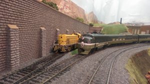

The Kato drives are second to none. My Alco fleet is all Kato drive units, first edition when they first came out some time in the 90's. They still run like new. I had looked at the Stewart F units, but I already had my Alcos all custom painted and detailed. The Athearn Genesis locomotives do have a little bit better detail than the original earlier Athearn locomotives. I picked up 2 A units and a B for my North Coast Limited. They are excellent, smooth running locomotives.
Unfortunately, I don't run the entire train. Just us one A unit and a few coaches and dome cars for my tourist train. It waas the only excuse I could think of to have the NP train on my layout. I do use a few "leased" NP passenger cars and and RDC for a local passenger train.
That's a nice looking Genesis F9. I've always like the NP paint schemes. I'm thinking about getting the Genesis SP Black Window F7s when they come out early next year.
