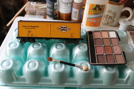

I used one of these containers for a temporary cradle while I tried out weathering with eye shadow on a boxcar.

Until you decide what cradle to get for your future projects, you can use one of these egg cartons.
