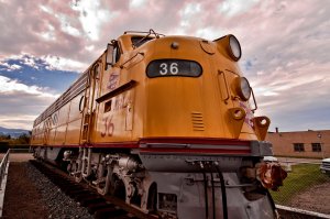

I rode on the Hiawatha in the 50's when I was a kid. Loved the Sky Dome car. I can't recall if I ever saw a FP7A at the head end. When we left, Joes were at the head end and I do remember the Erie Builts and E units taking over at Harlowtown. I didn't really pay that much attention being a kid, but I imagine that F units could have been on the head end too. Here's a neat picture taken at Deer Lodge a couple of years ago of a restored E unit.
