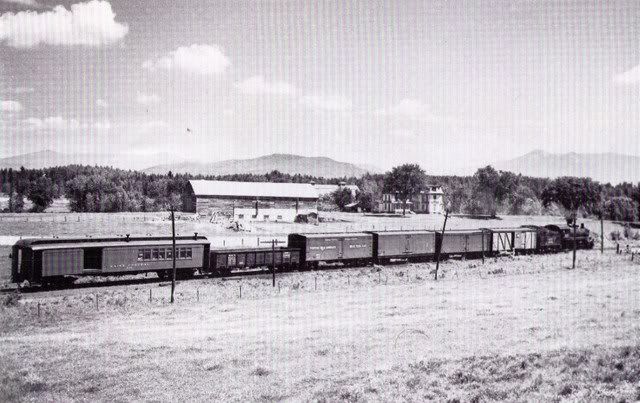

Thanks for the info. I am pretty clear now that there were two types of milk cars that looked rather similar. One was a milk "can" car and the other a milk "tank" car. My confusion is trying to figure out which type was used on the Beecher Falls branch of the MEC Mountain Sub.
http://i16.photobucket.com/albums/b34/woodcanoe/001-2.jpg
The photo was taken in June 1949, at Northumberland, NH, on the Beecher Falls Branch. You can see the way-car behind the engine, 3 milk cars and the combine. Like most photos of the milk cars in this area you cannot see the trucks or the lettering on the cars. I am going to make an assumption. I know there were 3 creameries on the branch. There were usually 3 milk cars in the consist. That would make sense. Since it was coming from a creamery as opposed to farms I am assuming it was transported in milk "tank" cars. But Dwight Smith, who researched a lot on them referred to the one pictured in Crawford Notch as a "can" car so therein is the confusion. I suppose it is possible that both types were used but I kind of doubt that. 3 creameries and 3 cars pretty regular is pretty good evidence that the output of a creamery was in each car.
These cars were moved in passenger trains most of their lives so the high-speed trucks were probably a given. Don't know why the Intermountain cars do not have them but they are models of cars used elsewhere, might have been a different situation.

SRM, pretty cool picture. Sure from a different era than we see today.
I took the picture and blew it up and the third reefer back does say "Milk Tank Car". The other two don't but the contruction leads me to believe they are tank cars also. "Milk Tank Car" was painted on the early version of the tank car to distinguish it from a can car. By 1949, there were so few can cars around that I suppose the designation for tank car wasn't needed any longer. The two front cars appear to have faded lettering that may have carried the tank car designation but the resolution is too poor to tell.
The only thing I can compare the trucks to are the combine truck lengths. The milk tanks cars appear to have much shorter wheelbase trucks than the combine and are close to the wheelbase of the gondola behind them. I'd guess these were modified Bettendorf swing motion trucks with a leaf spring, very similar to a caboose truck. Slightly larger than normal but not as large as the older express trucks. I think the Intermountain cars just use standard freight trucks because they are the cheapest thing to use. There were so many truck variations that they are lucky if they get the paint scheme variations right. :)
