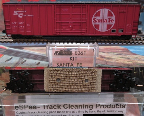

eSPee™ Track Cleaning Products sells a variety of rolling stock in 0-, H0-, and N-scale with the Masonite pad already installed (about $30 for the H0 versions). Here's an H0-scale listing for an Athearn boxcar on their eBay store here (make and model of boxcars vary). They also sell the pad separately with instructions on how to attach the pad to your own rolling stock—the H0 version is here.
Here's the Roundhouse N-scale boxcar with MTL couplers I bought from them for $32.57 (shipping is free!):
I'm very happy with the quality of the product and the Roundhouse Santa Fe boxcar I got looks and runs great! Again, they offer free shipping, plus free return-shipping, if for some reason you're not satisfied with your purchase. So for a few bucks, they do the work for you, and you might get a neat piece of rolling stock which matches your chosen road as well!
