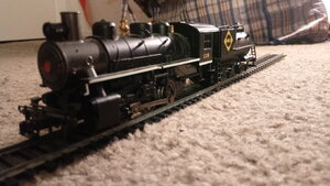

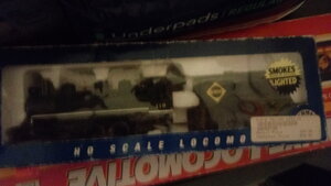

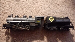

I have an HO steam locomotive that smokes. It's from Bachmann and it's a 0-6-0 TND/SMK ERIE HO, item BAC50735.
It smokes when you apply smoke fluid through the smoke stack and run it long enough and then poof poof it smokes! Pretty neat too!
I don't know if they're still available though, I bought mine back in 2005. 1615021770145781576024.jpg
For clearer pictures
Does this help?
