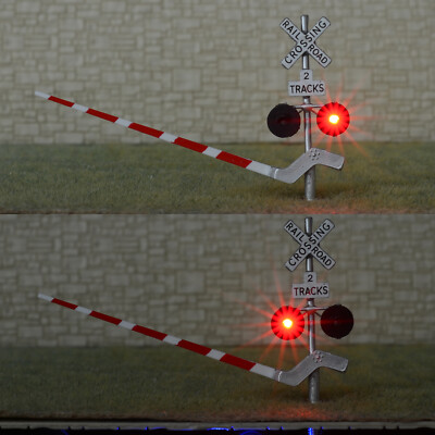

Wehonest is a Chinese company that makes (copies) lots of model railroad equipment. They are a reputable company, but quality varies, mostly good. I can only speak for static items like street lights, figures and trees as that is all that I have used. If Azatrax has all that you need, by all means go with them, but Wehonest may be able to fill gaps for you. Many of their products are stocked in Amazon warehouses which offer a much shorter lead time than Ebay.

I've dealt with Wehonest, over the last couple of years, and I've yet to be disappointed in their stuff, it's Chinese, so quality is not the best (is anything these days?) but having said that, as long as your not intending to use brute force to install it, you'll be fine, if there's a problem return it for a refund, I've done that too, no a problem.
