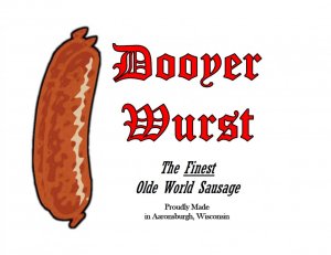

I'm hoping to get a few of these turned into decals and use them for billboard reefers...
I've googled a few places but if you have any particular recommendation I'd welcome that!

You can use Microsoft Word too make decals also.
I just downloaded your picture and took it into Word.

I did some decals for PlowGuy on here. They turned out really well I think. Do you have a printer? If so, what is it? I used a Dell 1320c Color Laser with Laser printer paper I got off Amazon. I could give you some graphic design help and some pointers if you want to try it yourself. Trust me when I say it really isn't that hard to do it yourself.
If you cannot find a cheap source I could print them for you. I have CorelDRAW X5 to manipulate the graphics. However, and NSacler will probably agree with me, not only is making your own easy but also you can get hooked on making unique items because it is so easy.
:) Well, the whole thing started out in Word, so that's helpful to know. (I built it in word, then made a PDF and then converted that to the PNG file that I posted.)
Thank you for info about using the printer to make a decal -- I thought one could only do that with a laser printer. I'll have to look into that further.
