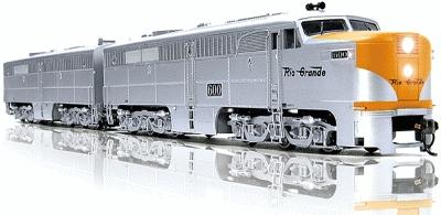

Did any manufacturer produce an HO scale D&RGW ALCO PA in the Aspen Leaf scheme? Like the Precision Craft version:
Or will I be painting my own?

I think you will be painting your own.

none by Athearn, P2K, ConCor. Don't recall eer seeing one in brass, either. Yep, looks like you'll be doing your own. Beautiful engine. Phil
Well, I just found that Precision Craft did these in HO scale ... prior to their change to/acquisition by BLI. Anyone know anything about Precision Craft models? Detail level, how they run, etc.?

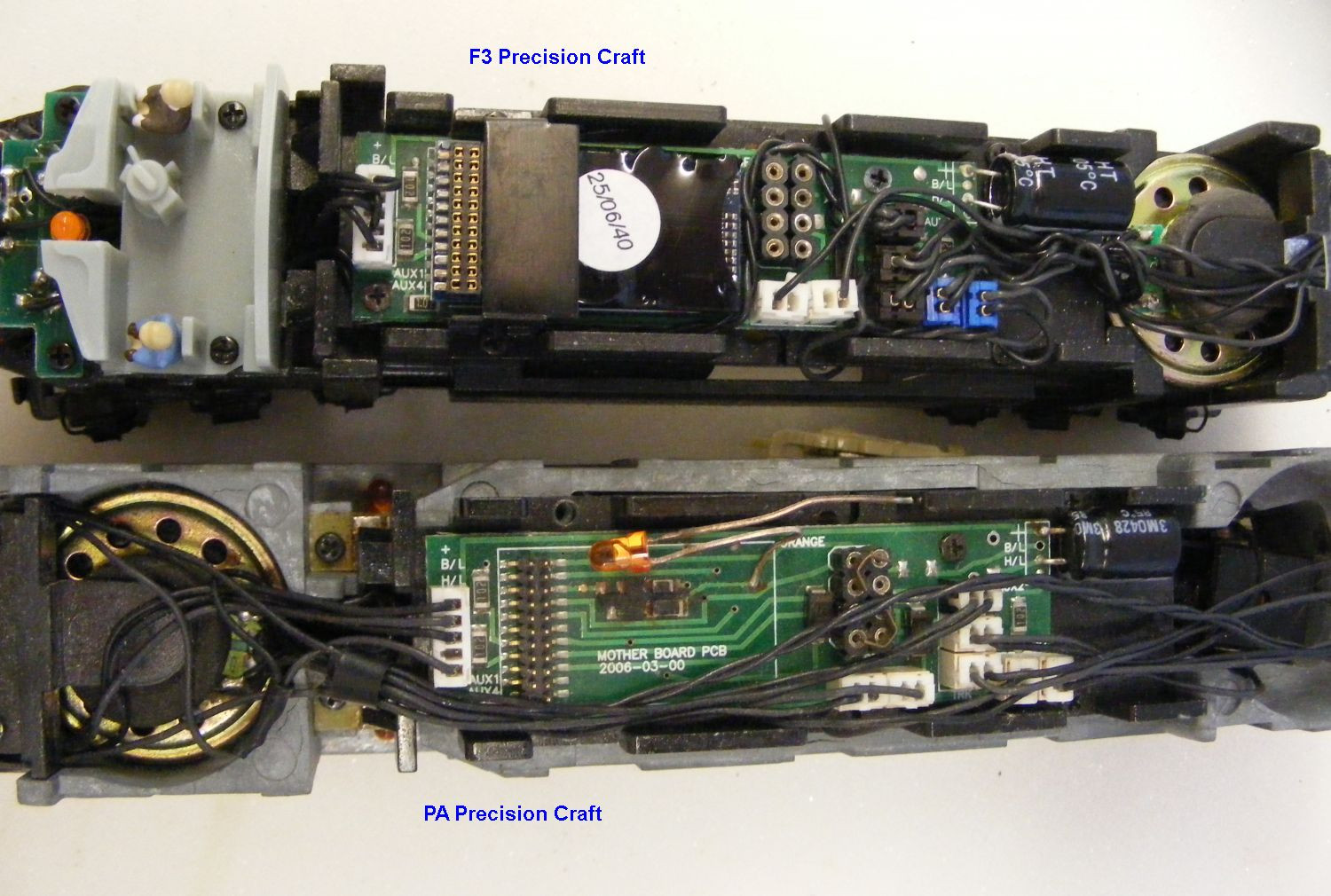

I have 2 sets AB of F-3's that I purchased from BLI long ago. Interestingly they have a connecting cable between the 2 units such that it appears as though there is a single ESU decoder controlling the motors on both units, and all 3 speakers. Is that true??
I have another AB set of PA that appear to have that same arrangement. I want to put a decoder in these that will accomplish the same thing,...run both motors and the 3 speakers..
Here are some reference photos of my locos,
https://forum.mrhmag.com/post/pa-locomotives-in-ho-help-identify-12693497?pid=1335660676
https://forum.mrhmag.com/post/pa-locomotives-in-ho-help-identify-12693497?pid=1335654119
Can you tell me how this was possible,..OR lead me to any link that might help me understand it??

1) I have some cheap MRC decoders (Universal GE U23) I bought long ago to play around with. they have an 8pin plug that would fit in that one receptacle on the PA boards?
a)Probably would not be asking too much of it to power the A-unit alone with its one speaker?
b) But how about if I hooked up a B-unit with its additional motor and 2 speakers??
2) I happened to find three 3 Soundtraxx 21 pin Tsunami in my inventory (TSU-21 PNEM8). Would I dare use one of these for such an experiment??
No one had an interest in this subject any longer?
I would really like to hear the sounds from these Precision Craft PA's I have, particularly with their multiple speakers,...just as an experiment before making any other decisions on what decoders to invest for them.
Of course I don't want to burn up any decoders trying this, so how about some advice?

You can run two motors with one decoder, I've several dual motored DD40's with that setup, and I'm using cheap decoders to run them too, so a higher end sound decoder like a ESU or Soundtraxx should be fine, not 100% certain any decoder will run 3 speakers, suppose it depends on the total impedence, and I imagine they would need to be in series, you would have ask an expert I would think.

Short answer is, no Precision Craft is the only non-brass manufacturer to do that paint scheme. They did it to match the California Zephyr cars released at the same time. They also did the CB&Q F3s A-B-A in passenger scheme, and a WP set A-B-B. Basically the very first locos to pull the California Zephyr.

Motors are easy as one can measure the current draw and make certain to get a decoder that can handle it.
Speakers are trickier. Hook two x ohm in parallel and one gets x/2 ohms. As I recall, at the time the ESU decoders that were used required 32 ohm speakers. So one has to assume BLI designed it so it could power all 3 safely, never presenting less than 32 ohms to the sound processor. I would have done that by putting a 64 ohm in the A, and the two in the B in series with each other so then parallel when plugged into the A.
EDIT: Just did a little bit of research. Looks like the ESU 58429 would drop right in. For motors I don't see a max current specification, but they talk about both HO and O scale so it should have enough umph for two HO can motors. Speaker specification says 4-32 ohms. So, if those are original 32 ohm speakers even if they are all parallel it will be well above the low limit.
And as a bonus it has RailCom!
