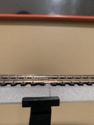

UPDATE - Omg. I feel like an idiot that I didn’t see this before - can this cause a short circuit or create an issue with controller and/ or loco and/ or track if I tried to run loco ????? I also just attached the turnouts from new upper track and it blew the power distribution module I was using - I don’t believe in coincidences.

No, not a short, but as the train passes close to, or over, the joint, it might flex things open enough to break the circuit, in which case the train obviously will stop....or it won't respond to commands if it is stopped over the joint and you want the loco to move.
Really shouldn’t be anything but a bumpy track, but could cause a stop in electrical flow, but electricity is flowing both ways so if it’s a loop track shouldn’t matter, point to point would be different… And that’s only 1 track of two, why does it not run on either track?
Well if the frame of the loco touches the rail, it may cause a short, but I would think any short caused by this would not affect the DCC unit.
