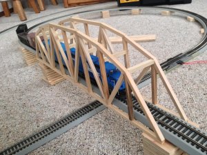

Not to hijack the thread, but I thought you might enjoy this.
