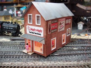

Clear mailing labels work great for this. You can print them straight out or reverse the image and print them backwards.
Here is a photo of one of my last scratch built buildings with clear plastic windows and clear labels on them. all the signs and window images are printed on mailing labels. I haven't even found a place to put it yet.
