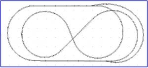

My initial concern is the amount of room you have to obtain the grade needed for you cross over. "General rule of thumb" is you need 100" of horizontal track to attain an X percent grade. In other words, for N Scale, to achieve a 1.75" clearance at the cross over (or just prior to it) you will need 100" of horizontal track with a vertical height (at the cross over) of 1.75" as well as a little more horizontal track to accommodate the transition for the grades up and down.
The "good news though" is this - A lot of people say that N Scale trains can negotiate up to a 4% grade. IF that is true, taking into account the engine type and number of rolling stock being pulled, you could achieve a 2% (1.75%) grade over only 50" (4') of horizontal track.
I think I'd move my turnouts back a little from the start of your curve, top and bottom. Most N Scale modern engines are around 5" - 5.5" in length so if you were to move the turnouts back into the straights about 6" from the start of the curve, I think you'd be better of and reduce the possibility of any potential problems.
Sorry to be a little bit picky, but better to have "possible issues" pointed out before things get started.

Did your plan in SCARM and you have plenty of room for the cross overs
Took the liberty of modifying yours a "little" just for interests sake.
Here is your plan in 3D:
Oops, got it back the front. The left side in the shot is really the right side and visa versa
Modified:
No problem, just thought you'd like to see how it would look in 3D. Feel free to tell me to butt out if you think I am interfering though.
LOL! No problems with ya here wombat. I appreciate all the comments, and help from you and others.
I would "reverse" the grades. That is make the underpasses bridges, and the bridges the underpasses. That would reduce the steepest grade, and reduce the over all gradient of the entire plan. But that would also cause a totally different scenic effect.
Good point horseman, although the steepest grade was a little less than 2% from memory. I didn't save it either so I can't switch things around for comparison.

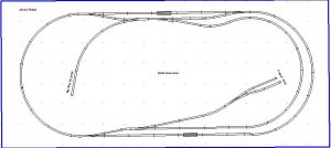

An update, I'm getting ready to order my track for the layout below, but before I do, I wanted to put this out there. This ended up with more switches than I wanted to deal with, but it's what is needed to get what I wanted in the layout. As you can see, there are three spots the track doesn't come together, but I think that when I actually lay the track down, it can be tweaked, and coaxed into position.
If you use flex track there wont be an issue with the track joining together properly. From how it looks, it just seems as though the drawing of the track is a little out of alignment at the bottom so nothing to worry about
Yeah, I can see a couple places using flex will help.
I'm just going to do the outer track for now with three switches to access the inside track, which I can add later.
That'll work and wont tie you into anything. Who knows, you may want to add track to your sidings.

The diagram says Atlas track. Is it really? The geometry of the turnouts seem more like Kato UNItrack.
