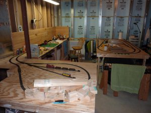

Here's what I've got going on. It's long-term, temporary, but it has a good run.

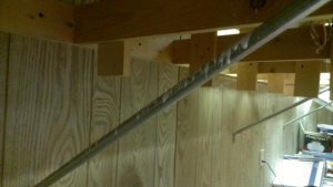

Here's a cheap, strong and quick way to mount the benchwork to the wall. I use half inch rigid electrical conduit. Flatten the ends, drill a couple of holes in each end and screw one end to the inside of the facia and the lower end to the studs in the wall. I have had 200 plus poud people put their entire weight on the outside edge and the benchwork didn't budge. The benchwork is made from 1 x 4s screwed together. This is an old cabinet makers trick and works extremely well.
