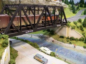

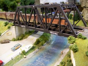

Here are my results. The first was on my second layout, now dismantled three years. The second is a diorama I took outdoors and staged in a local setting. I used image-stacking software for infinite focus to make it look more natural.
index.php
This comprises a tinted plaster riverbed, local screened gravel, and two pours of finish quality epoxy. Over the epoxy, which was glassy flat, I stippled some gel gloss medium. Importantly, in the second layer of the epoxy, I mixed a drop of Hauder Green (Walmart craft paints), a half drop of plain yellow, and a pinch of plaster of Paris powder for turbidity.

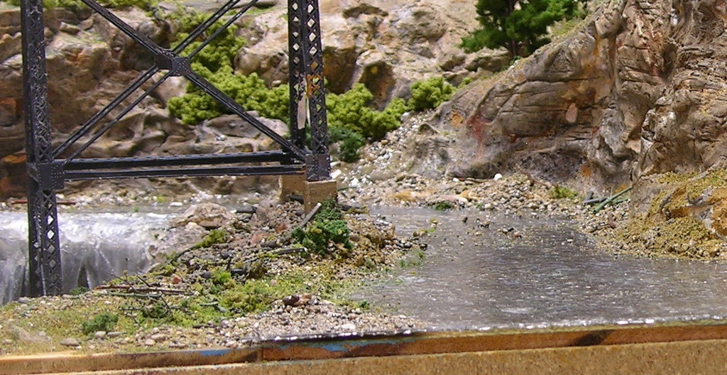

I more-or-less duplicated the process in this outdoors diorama, but I painted the riverbed rather than craft a plaster bed that was tinted. The actual surface was the white plasticized surface of a chip-board shelf, so it took paint well.

That would have to be the best water modelling I've ever seen, the top pic taken looking down into the water has exactly the right opacity and transparency balance.
new guy
Active Member
THAT'S what I'm talking about! The rocks, being able to see only part way into the water and that "roiling" effect on the surface, really makes it "live"! Well Done Sir! I gotta book mark this one for when I start scenery!

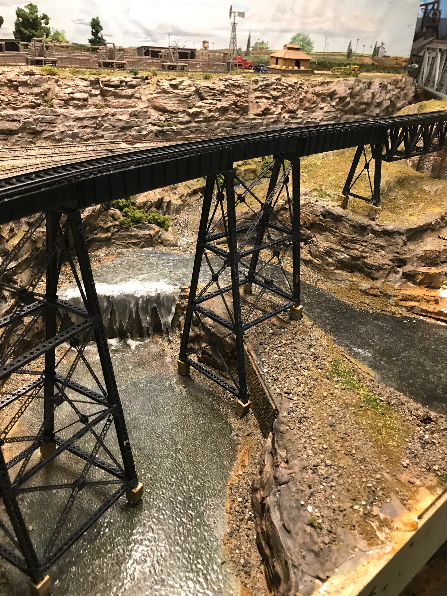

Here is a quick way to make "water" ... (Note: I did not say "correctly". LOL)
Here is a scene from my recent bridge project. (This is fictional scene, and I suppose a railroad civil engineer would count some rivits for me. LOL ) ... I will explain how I made the water under the bridges.
I used an acrylic light panal from a drop ceiling. The kind is called "crushed ice". I salvaged what I needed from a broken one. I will explain the simple steps.

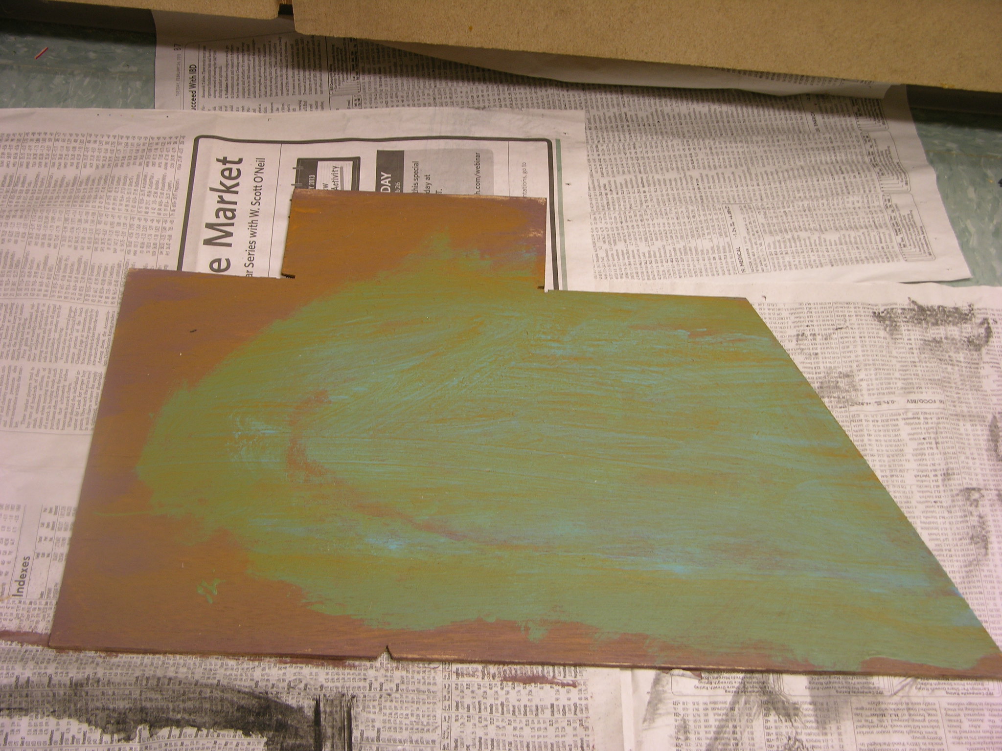

First, I cut some 1/4" plywood to be the base surface. I painted with blue (center of water surface), green (closer to shore), and brown (at shore). When paint was dry, I applied a wash of raw siena acrylic paint (watered down) over the entire surface of the plywood. (This will be the section under the waterfalls.)

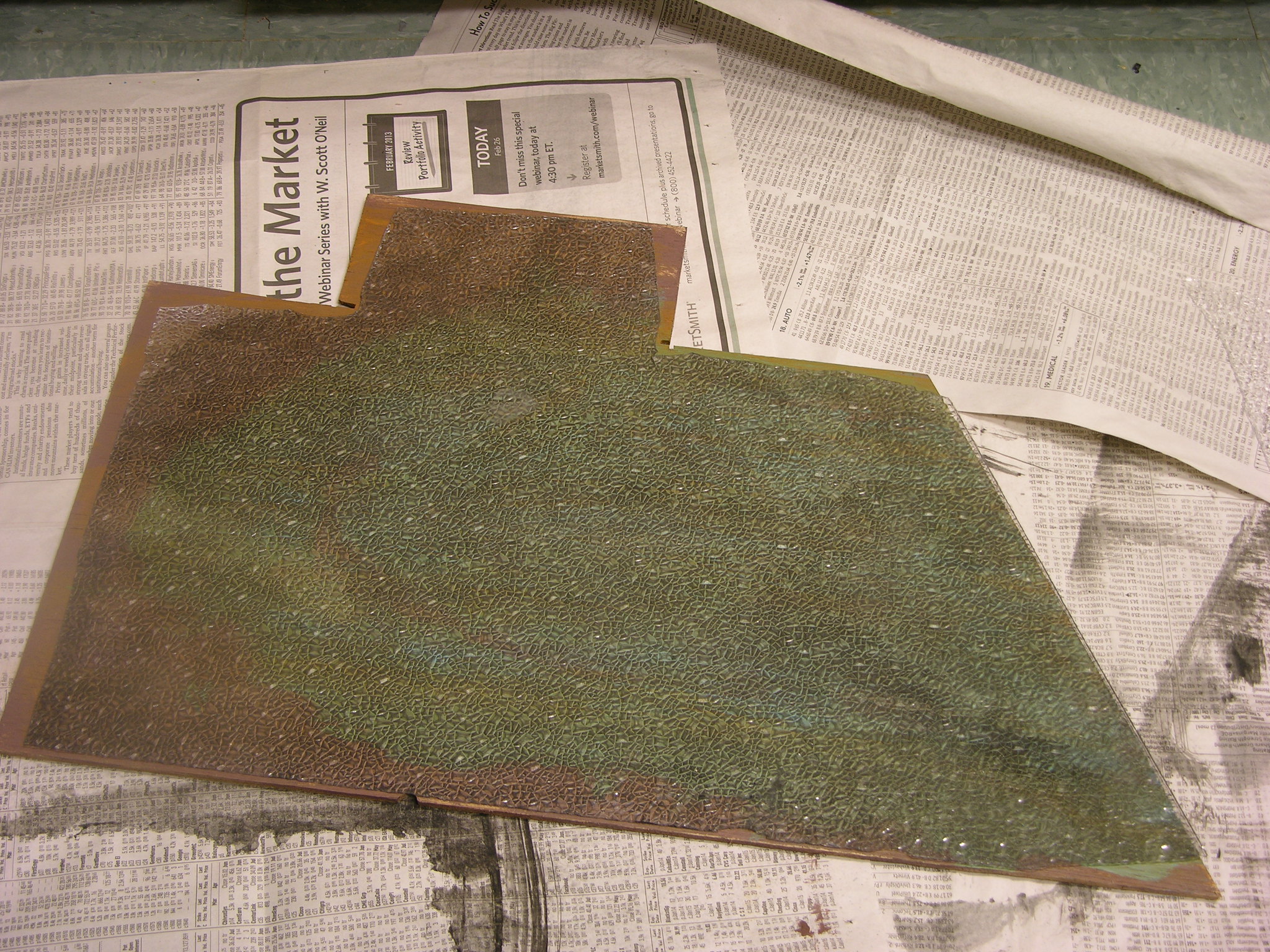

Next, I cut a piece from the acrylic light panel. I turned it so it was crinkle side up, and applied a very thin wash of acrylic black paint. I sprayed it with soapy water while paint was still wet. Then, I waited for it to dry about two days.

I included waterfalls which were made with Woodland Scenics Water Effects. Before applying that, I made some clear plastic pieces.
