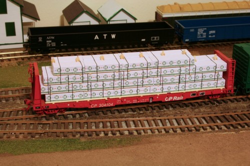

Walthers sells plastic two piece wrapped type lumber loads just like in Serial Kidders photo's. You just plop them on the car and run! In fact one of mine looks just like the northwood type in his photo.

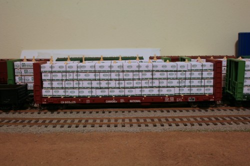

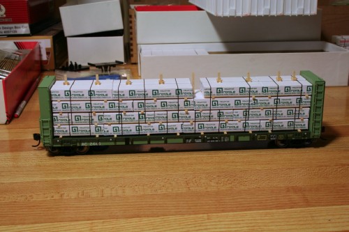

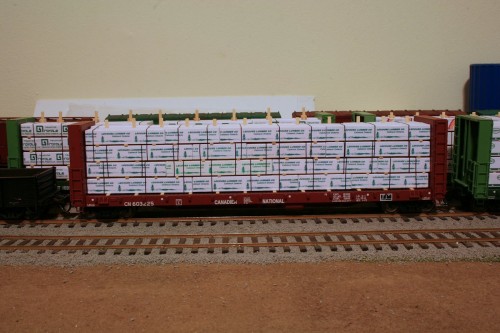

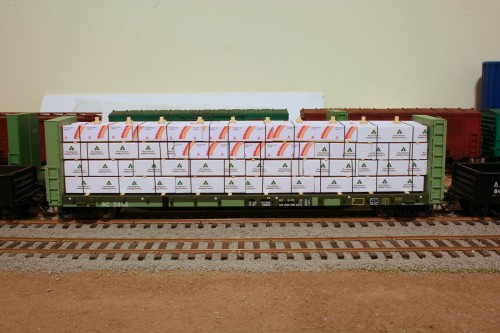

Some of the home-made lumber loads I've made (in HO).
Graphics are prepared by myself on the computer, printed out on white paper and glued and wrapped around individual wood blocks, assembled into a full load with stripwood spacers and glued together as a solid unit. (Loads are not glued to the car itself and are removable). Banding is 1/64" chart tape.
Note when building a load for a regular flatcar, since there's no structure to stabilize the load as on a center-beam flatcar, the bundles must be staggered and banded together to tie the entire load into a solid unit. On a center-beam car, the bundles can simply be stacked, as the bundles are strapped directly to the central truss structure of the car with the winch & cable tie downs.
