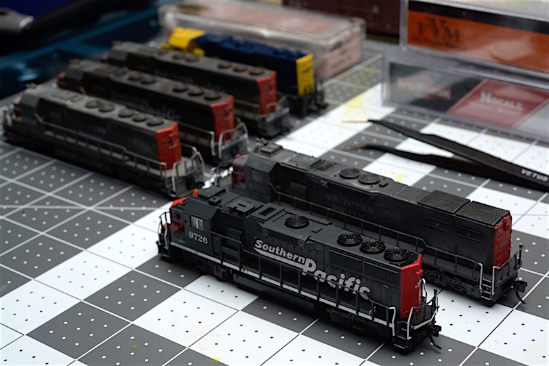

While some decoder installs are a breeze (and some, not), it's just one less thing to have to do! Here's a few of the several dozen locos yet to be installed:
