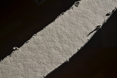

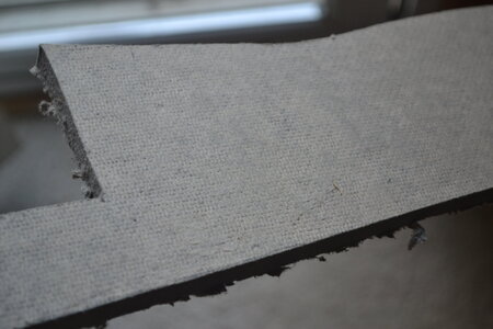

So SoundBarrier 440 is the product commonly called homasote and used on model railroads that is being discussed? I used "homasote" 30 years ago with my last permanent layout and it just looked like wadded up newspaper pressed into a 4x8 sheet..
440 SoundBarrier® is a special-density, structural board made from 100 percent environmental Homasote® cellulose fiber, a homogeneous composition manufactured with uniformly distributed protection against termites, rot and fungi, and resistance to moisture. It also insulates with twice the R-value of wood.
I can't tell it's newspaper from looking at it I do know it's made from a ground up slurry
