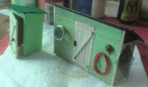

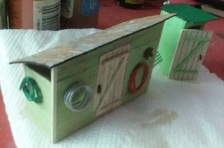

Rather than giving you several pictures of all the labor pains, here are the outhouse and tool shed I put together to go with the mill house.
