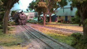

Don't worry about it. Once you apply ballast, you'll never see the kerf lines. Here's some pictures. My entire layout is on Homabed. LOVE IT !
