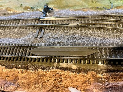

I use them on my code 83 Peco track. I think they are Code 100 files that I adjusted the height a slight bit. I have about 6 or 7 around the layout. I can now run trains for a long time without derailments.

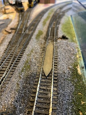

Eric , I have the railer in place somewhat but have not had a chance to run the trains to see how they work. I took a picture and I have yet to paint them but they look great.
